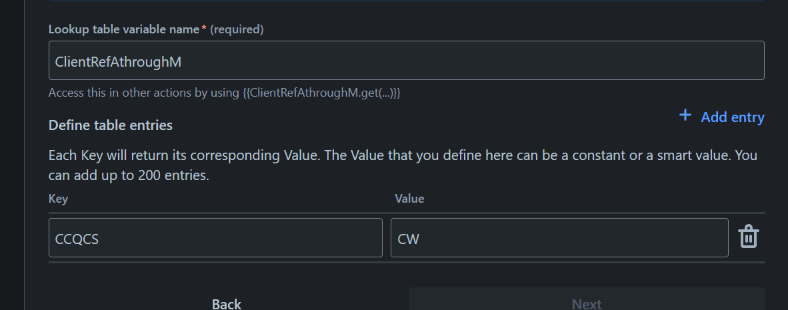

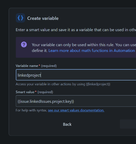

We link our service desk tickets to our product tickets
Our product tickets have a checkbox field called Clients.
I have the trigger working the way I want but it can't find the lookup value correctly.
Here is what I want to happen:
  • Read the project key from the linked issue.
  • Create a variable from the project key.
  • Use that variable value to reference the lookup table key, to then find the value to set on the Clients field.
"update": {
"Clients": [{ "add": {"value": "{{ClientRefAthroughM.get({{linkedproject}})"}}}}]
ClientRefAthroughM = lookup table name
linkedproject = variable

Hi @Celina Kincaid
Once a smart value expression is inside a set of double-curly brackets, you do not need to add more.  There also appear to be some extra brackets in your expression.
For example:
"update": {
"Clients": [
{ "add": { "value": "{{ClientRefAthroughM.get(linkedproject)}}" } }
As a tip, when writing JSON expressions for rules, try first creating them in an editor which shows if the brackets, parentheses, etc. match up.  Once they do, copy-and-paste the expression into your rule for use and testing.

Thank you Bill!!  That helped.  The automation is running but it's finding an empty value.
Can you peek at my attached files?  It's saying
"PLAYG-65 (Option value '' is not valid (customfield_10097))"
Not sure why it's just seeing a quote and not finding the CW from the criteria.Snip - Audit log - Automation - Jira - Google Chrome (7).pngSnip - Audit log - Automation - Jira - Google Chrome (8).png
Celina Kincaid
November 18, 2024
I started adding log messages and could see where it was breaking.
I figured this out.  I changed my variable to {{issue.key.substringBefore("-")}} to strip out the project.
Thank you!!
