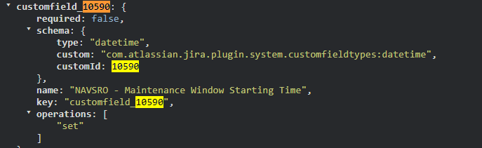

Start time (customfield_10590) : 2022-12-19T09:30:00.000-0800
NAVSRO - Maintenance Window Duration (Hours) (customfield_10592) : "6"

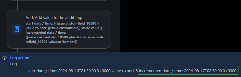

Please try writing these to the audit log to see if they match what you expect:
start date / time: {{issue.customfield_10590}}
value to add: {{issue.customfield_10592.value}}
incremented date / time: {{issue.customfield_10590.plusHours(issue.customfield_10592.value)}}
After you confirm the math is working, then you can focus on the formatting.
Thanks...Now adjust that last one to convert the text to a number:
{{issue.customfield_10590.plusHours(issue.customfield_10592.value.asNumber)}}
