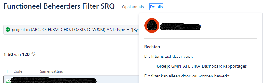

assuming so can you please verify that this user has access to the filter by going to the filter and clicking on details and inspecting the share.
Hi Jack, i'll try to make it more clear:

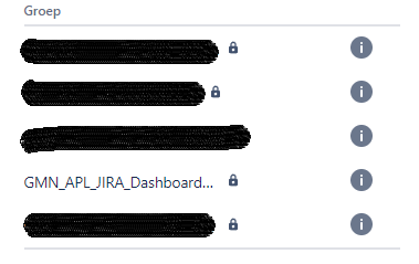

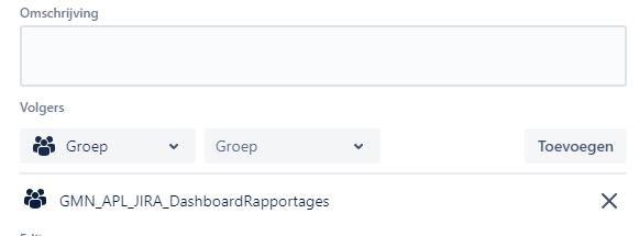

User is member of this group:
This group has access to the dashboard:
This group also has access to the specific filters i'm using in three "Filter Results" gadgets

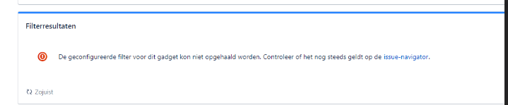

Yet, when I log in as this user, I get no results, as per the image i shared above. My OWN results are exactly correct:
You've gone over most of the permissions in detail there, but there's one missing - can these users actually see any of the issues they should be seeing in the gadget? (I know you've said "in the project", but that doesn't necessarily mean they can see the issues)
Hi Nic, what permissions would that be? Would the Browse Project permission suffice, or another permission?
For instance, the user can see one out of five projects in this filter, yet the filter returns 0 issues, despite there being ~1000 issues in this project the user has permission for.
It may be more complex than permissions, but there's a quick test - from the issues that you can see, pick one that your other user should be able to see in the gadget and get them to look at it in the issue view. If they can see it, then it's not permissions or security.
But your last screenshot answers it. The gadget is failing because the filter behind it is not valid.

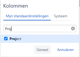

There's a quick test for this - go to the issue navigator and run a search. Doesn't matter what it is; we're not looking at issues. Now go to the "columns" button and type "project" into the search. There will be more than one if I'm right.
TLDR: solution - rename the "project" field in the project that is breaking it.

Oh. Bother. I want to ask if you're sure there are no TMPs, but your screenshot of the project selection in the issue navigator is the most important thing - it rules out my "two fields called project" theory.

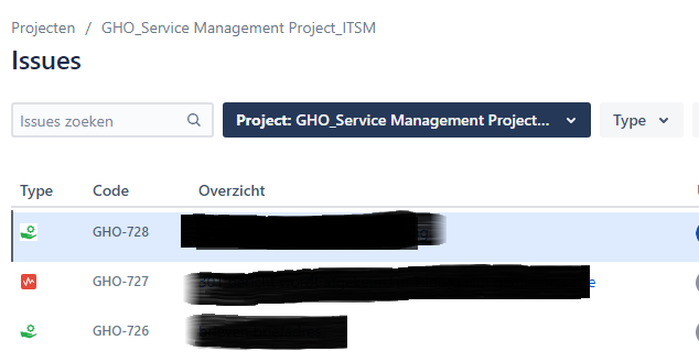

I have logged in as the same user as before. Under Projects, I can see the project containing al JSM issues this user should be able to see. Opening the project, I can see the screenshot below, and opening any issue shows the proper issue views:
So the issue permissions are not the problem in this case.

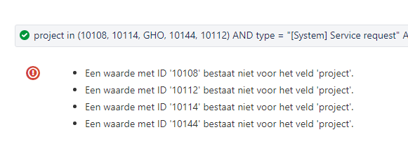

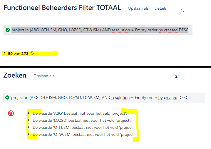

I have tried your suggestion on my admin account and on the same user account as before, and I get the following results. The top half of this image (marked 1.) is the view I get as an admin. JQL query is valid, and returns ~280 issues. The bottom half (marked 2.) is the user view, which returns a valid JQL query but also returns no issues. The text translates roughly to "The value '[Project Key]' does not exist for field 'Project'"
And, as per your last suggestion, I have tried to just type the JQL query out - which shows a red X as the user can't locate the projects I'm trying to include in the query:
"Test 2: Start typing the JQL into the search.  Do they both get the warning "10108 is not a valid entry for the project field"?"
And, for fun, I have also tried to find the projectcodes - which returns a valid JQL but again 0 issues as the value "Does not exist for the Project field":
I feel like we're homing in to the root cause - the pieces are there but I just gotta connect the puzzle. Thanks for your input so far!

I was barking up the wrong tree earlier. I've just tried testing this properly.
Yes, you will get the "does not exist for" message from the JQL if a user cannot see the project.
That makes sense. So the answer is that Juul will need different filters for his dashboards.

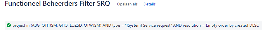

in a last Hail Mary attempt I have "split" the JQL-filter into its component phrases with a lot of <OR>. To no avail, since it still doesn't work, but I suppose its good to experiment - See block quote below.
So, to conclude, in order to fulfill the business requirement I have to create more than one dashboard, and create more filters, and create more IdP access groups. Bummer. I'm going to try to work around that...
Block:
(project = ABG AND type = "[System] Service request" AND resolution = Empty) OR (project = OTHJSM AND type = "[System] Service request" AND resolution = Empty) OR (project = GHO AND type = "[System] Service request" AND resolution = Empty AND resolution = Empty) OR (project = LOZSD AND type = "[System] Service request" AND resolution = Empty AND resolution = Empty) OR (project = OTWJSM AND type = "[System] Service request" AND resolution = Empty AND resolution = Empty)
