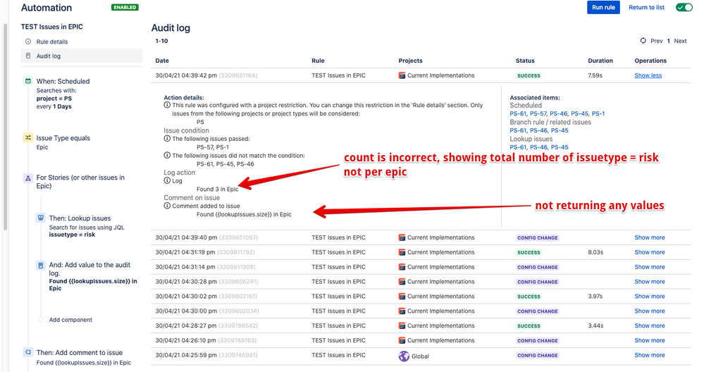

Really excited about the new Jira Work Management tool, and I am doing a POC for our professional services team to manage various projects with external customers by this team.
I am looking for a way to automate a status change based on the number of "Risks" that have been identified.
I have an epic for each project that is being worked on. If a risk is identified within that project, a ticket with issuetype = Risk will be created within the epic.
I would like to automate the status change of the Epic, if there are 2 or more tickets (with issuetype = risk)
I have setup the following logic to try and return the number of risks within an epic, but it is currently not returning a value. I suspect because the lookup is inside of the (issue in epic)
Additionally, even the "{lookupIssues.size}}" within the branch is returning the total count, and not the count per epic

I think you are close, and just need a few adjustments.  A scheduled rule with JQL runs the steps after the trigger for each issue found, so it may be getting a bit of collision on the issues to check.
How about something like this below...  Please check the names of projects and issue types to confirm what I read from your image.
  • Trigger: scheduled every day with JQL of project = PS AND issueType = epic
  • Action: Lookup Issues on JQL of "epic link" = {{issue.key}} and issueType = risk
  • Advanced Compare Condition: {{lookupIssues.size|0}} is greater than or equal to 2
  • Action: do what you need, comment, log, transition the epic, etc.

Thanks bill, that looks good. I did end up figuring it out a little bit after i posted this, but I left it up here to see what would be posted.
This is the solution I came up with which looks similar to what you did here except for the "size|0" part. Thanks a bunch!
