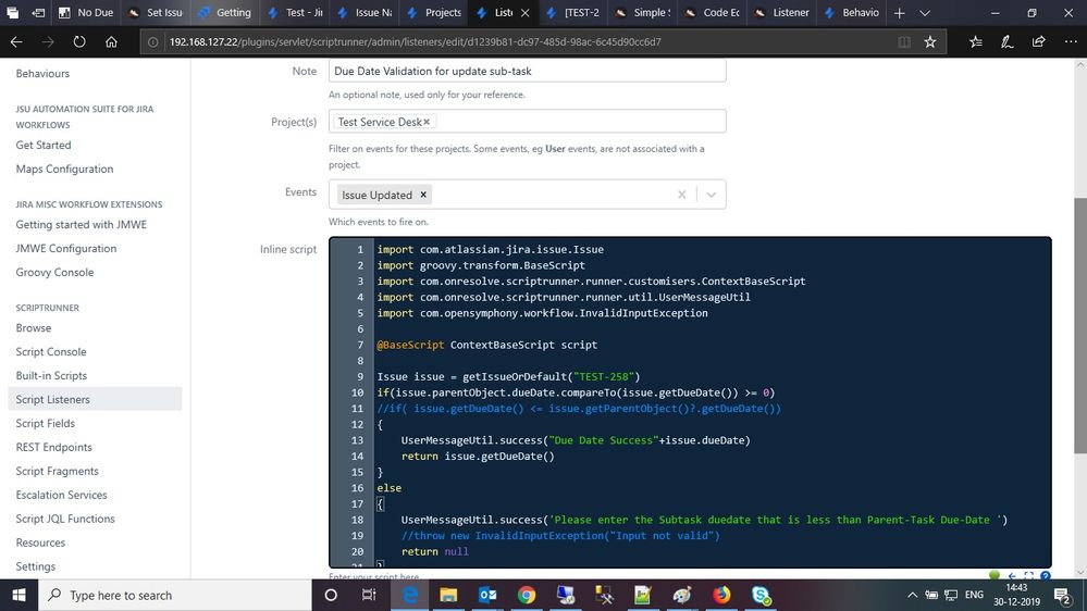

Thank you so much for sharing the answer. I will implement as per your steps provided. But the only question i am having issue update permission that how to handle the permission scheme?By default, jira is not validating any custom field when agent click on edit button.
Would you please check i had implement the script on script listener but i am facing issue on the same. I m searching for 4 days.
The two point is provided below which i need to fix:
1. I am unable to restrict for update the value of an issue at the time of issue update event. I had created a script on script listener.
2. Instead of hard coded value for key, i want to use dynamic code on script-runner. Means if the ticket is sub-task issue and project will be the same then the below script will execute.
Here the script is provided below and the requirement is duedate value for Task IssueType should be greater than the Duedate value for n number of subtask IssueType :

The problem is that when the condition fails then the Due-date will be update first and next the pop up alert is raised which i mentioned in the code but I am unable to restrict the due date update.
Also recommend us for second point on run-time environment(on production).
