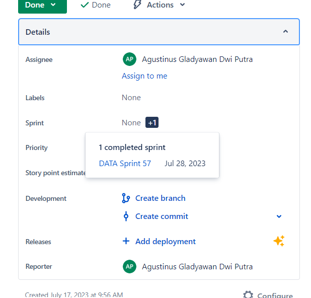

Dear @Loveleen Margareth ,
The "None+1" is a display introduced by Atlassian sometime now. Sorry I was not aware of that. But this display is not the source of your problem.
What @Marc - Devoteam explained is the problem here with you report, Atlassian explain the following :

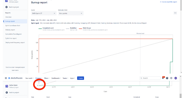

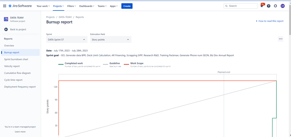

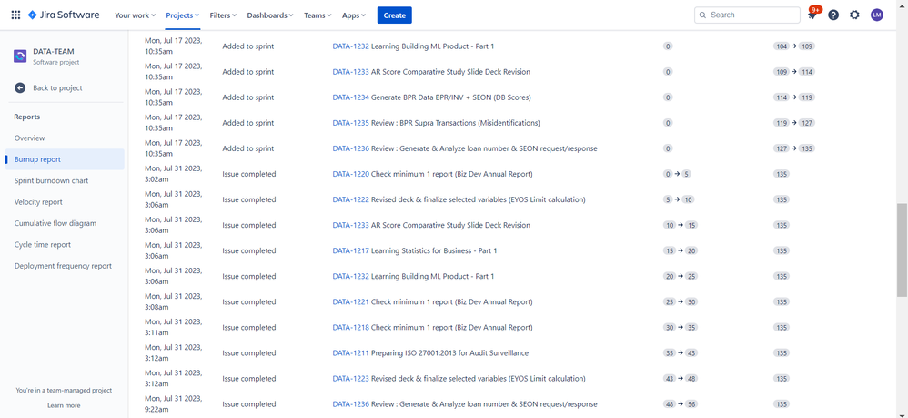

I see why the initial commitment was 8, this was the only issue in the sprint on starting.
All issues have been added after the sprint start.
If they would have been in the sprint from the start your burn-up report would show the start to work scope at 135 not at 8.
You see the red line moving to 135 after the start.

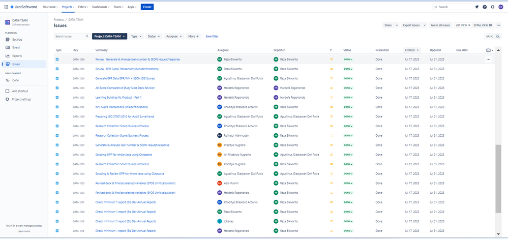

I don't know how to solve this problem, I already screenshot the issue and explain in more detail in the description column. please help me solve this problem. Thank you

I saw your description. To better understand the problem I just need more details about the issues you closed during the sprint. Do they have a resolution ?
I completed the sprint, and the commitment should be 135 and the completed 135 on the velocity chart, but instead there are 8 and 135. See the part I circled in the screenshot above.
and look at what I screenshot below, here it counts 135 for compliance and commitment. but on the velocity chart the numbers are different
Can you please check one of the issue you have completed in the sprint ?
Because I don't think the problem is related to the report.

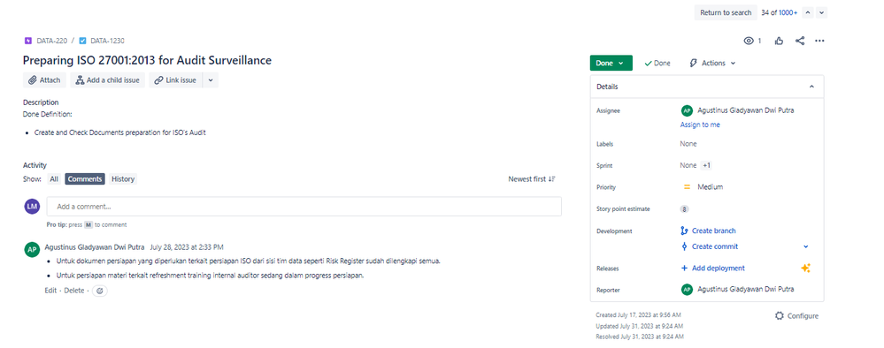

Check for example the issue DATA-1230. Can you verify that next to the status you see a resolution ?
In the screenshot bellow, you have status is Done and the resolution is Done.

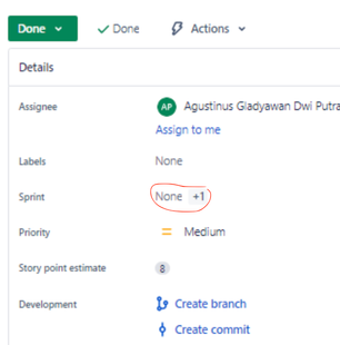

Hi @Loveleen Margareth ,
I see something unusual in your screenshot. The Sprint field in your issue is showing "None +1".
Can you edit the sprint field in this issue and check if anything changes in your report ?

As seen in the sprint report, you added on my request, I think that went wrong this time.
The red line in the report starts at 8 points and after start the line climes to 135, so all issues have been added after sprint start.
If all issues would be in the sprint from the start the line would have started at 135.
There is no relation on completing the sprint.
