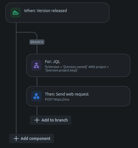

The debugging utilities (new to me, thanks) really helped out.  Ended up taking a very different approach:
Not the consolidated JSON array of issues in a single POST, but will work just fine for what I'm after.
Thanks!

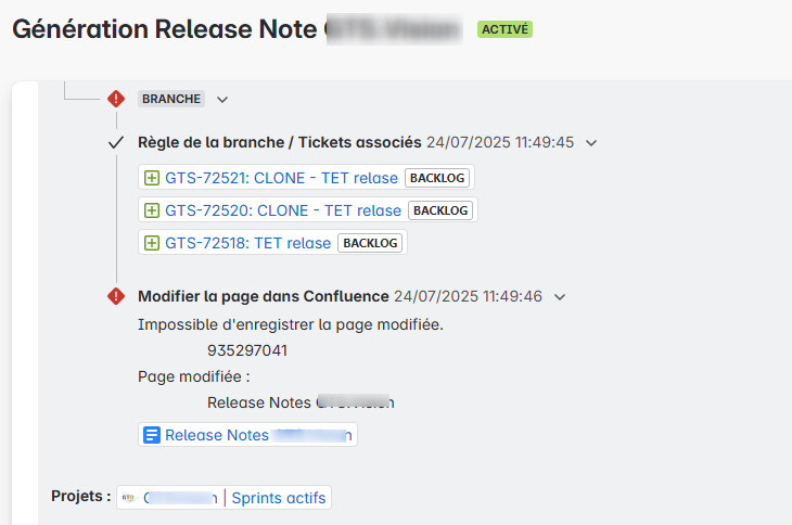

I tried your solution that will be find for mee too but when the loop work it only save the first jira, and an error pop
Have you had this pb ?
Thibault d_Arexy
July 24, 2025
i don't use web request because of bad format of the json body and i don't find a sample which work :/ so i try with update page
