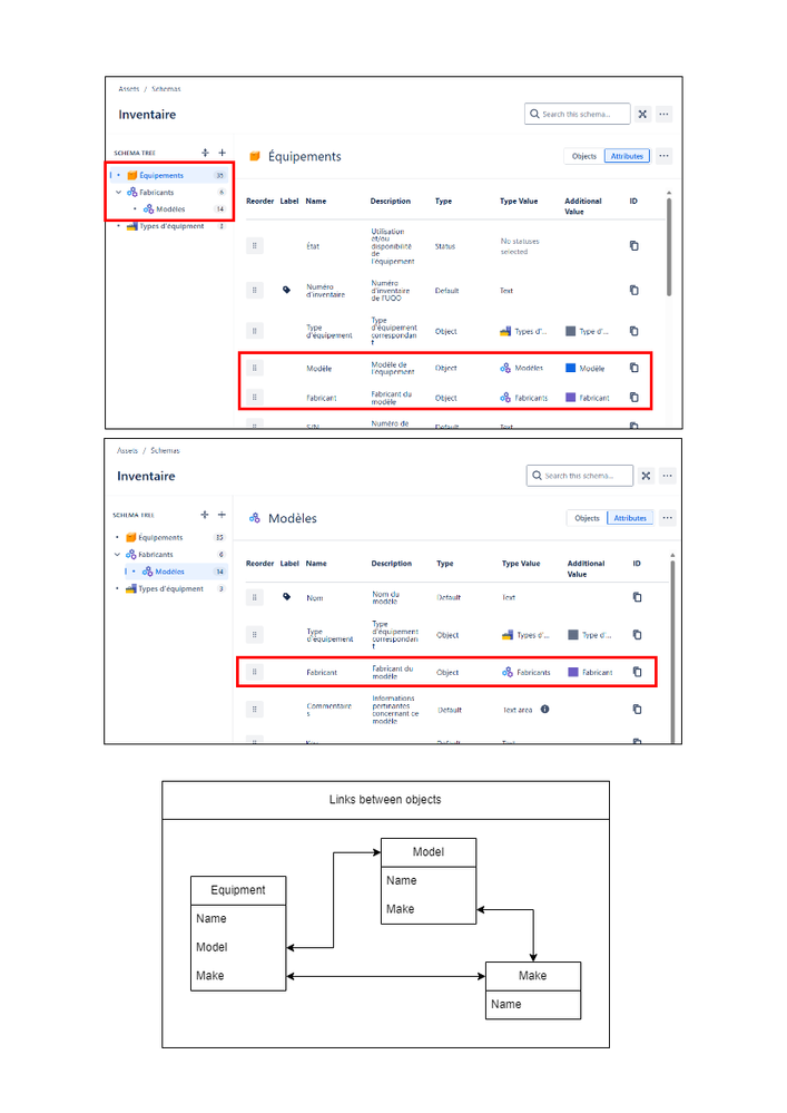

Hey @David Audet , can you please share some images on how you built it? or a design map?
David Audet May 21, 2025
Here are a few screenshots and a diagram of what currently seems like the best solution. The object types are in French in the screenshots. Just know that "Nom"="Name", "Fabricant"="Make" and "Modèle"="Model".
The issue with this setup is that there are two "Make" attributes. One for the Equipment and one for the Model and they can be different. I need to find a way to make sure that the attribute "Make" of an Equipment always corresponds to the attribute "Make" of the Model chosen for the equipment.

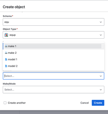

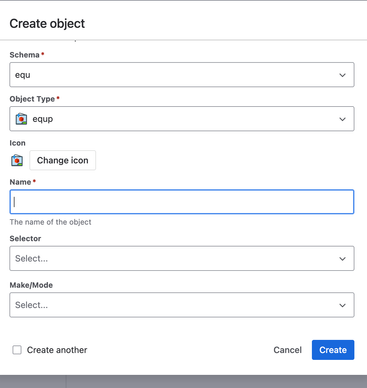

However, you might be able to do a selector of all Make and Model in one field, and then set the next field with the appropriate value,
is that something that could help you?
see image.

Yes that does look interesting! How can you select different object types in the same attribute? How would you filter the next field to automatically set the right value?
arielei
May 23, 2025
Hey  @David Audet
If you have a parent -> child objects then you can create an attribute for the parent object and in the "Attribute Settings" -> General - Include Children
There isnt a way to do that, so my advise is:
Tell agents to fill ONLY one param for their choosing - Model or Make - and then write an automation that will populate the correct value to the other attribute.
For that, you will need to have some naming convention on how to create Make or Mode to base the automation on it.
