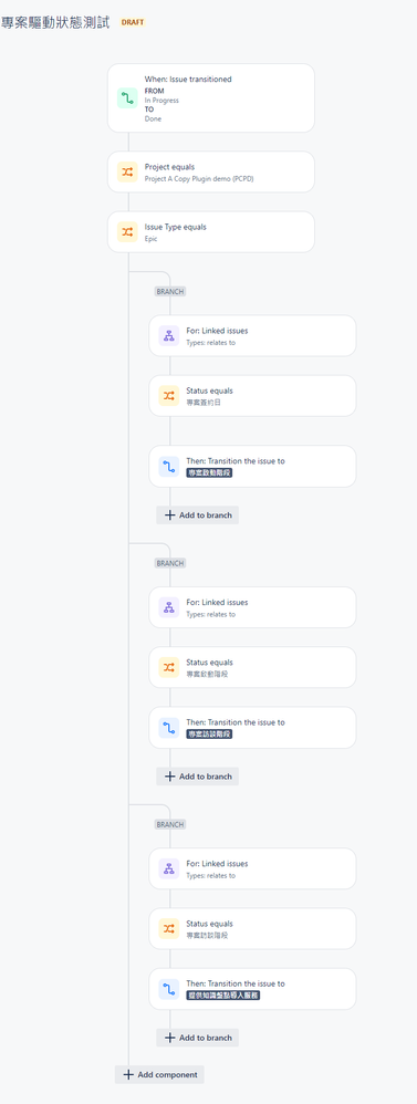

I would like to ask the professional automation experts on the forum.
I want to automatically advance Project B to the next state after Project A is completed.
But according to the Automation I set now, he succeeded, but it will not just advance to the next state. He will directly push the status of Project B to the end.
Please tell me where I am, I didn’t find the problem?

What's the relationship between the issues? Are they both Epics? If not, what issue type is the issue in Project B?

Yes , they're all Epic.

It appears from your rule that you have multiple branches that keep progressing the status of the issue. Why are you doing that and not just setting the value to a single status? Why so many branches doing so many different Statuses? They are all firing and passing and keep moving the issue.

So do I just need to set a branch?
Too many branches caused my project B status to be constantly pushed forward. Is there anything that is more correct or can you give me an example?

As John notes, the branching may be the cause of what you are observing:
Branches which could be on more than one thing run in parallel and asynchronously; there is no guarantee of when the branch will finish, up until the last step of the rule.
For the rule you show, this means all of the branch could be running at the same time, they do not run one by one, in the order shown in the rule.
