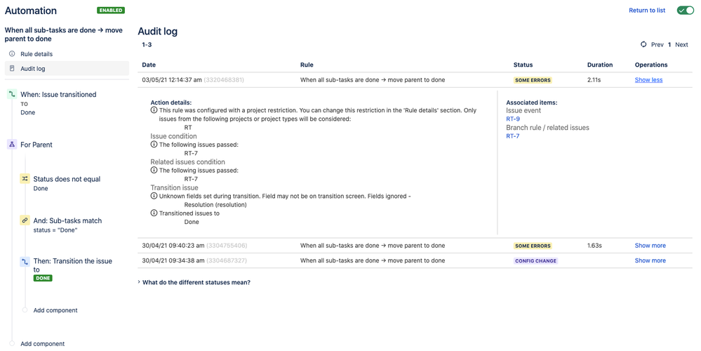

I created a rule from the library (When all sub-tasks are done → move parent to done) and used it as is, without modification - and it works.

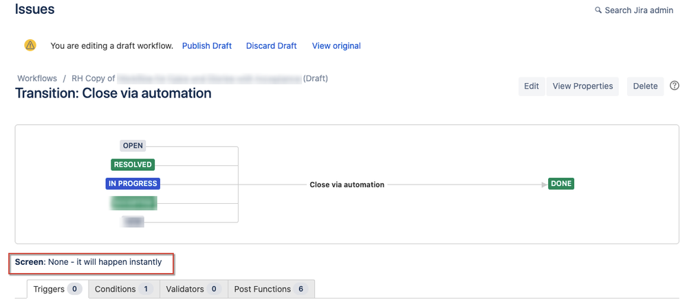

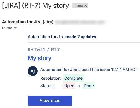

The rule closes parent tickets when subtasks are done. To do so I creates transitions from all other workflow statuses to Done so that automation could perform the transition. Also, the transition uses a post-function to set the resolution value automatically.
So as I mentioned, the rule works - the transition takes place and the resolution value is set, but errors are appearing in the audit log for the automation rule. I have not been able to find an answer anywhere.
So in case anyone is asking why I am posting another similar question, while I have found similar problems in the community - this seems more common than I would have guessed - they are not the same set of circumstances, and also, none of the posts I found were resolved. I would love to know what's actually happening.

Hi Rob,
It looks like it's not a major issue, but most likely there is a transition screen from the parent issue that needs to be filled out when you push it to done.
I would recommend the following:
1. Since you are using a post-function to set the resolution in the parent, remove the transition screen from the transition.
Hi Fabian,
Thank you, but there is no screen in use. That's why the post-function to set resolution is used.
Sometimes, I find that Project Automation and Workflows post-function conflict with each other.
I suggest the following then:
1. Remove the post-function in the workflow and set the resolution in the automation.
2. I would also add a condition after the status trigger to check that this only applies to Sub-tasks.

Ah, I bet your Automation is clearing the Resolution field. Can you check the history of the issue to see what is happening with that field?
Its not, the history and activity all look good. Honestly, from the looks of it, everything is working as designed, but there are errors

@Rob Horan We're seeing the same thing for transitions that are not setting resolutions (e.g. Backlog -> To Do) It seems that all transitions performed by the automation complain if there's no screen with a resolution. If you found/have a fix I'd love to know.
Hey @Matthew Knatz - Automation is not going to be able to call a transition screen. So you need to add another transition to the status being used in your automation rule and set the values that would be done through the screen. Then I would put a condition on the transition so that only the group atlassian-addons can execute it.
