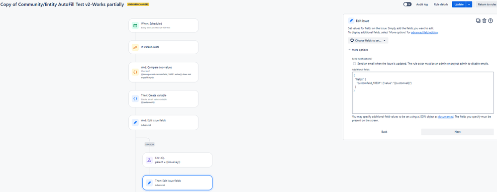

I have a custom field in Jira for "Community/Entity" that prompts me to select a community, then prompts me to select an entity #, then merges the two dropdown selections into one field with the Custom Field ID # (10031). I am trying to write an automation where if the parent has the "Community/Entity" field filled out, automation will fill the "Community/Entity" out for the child issues.

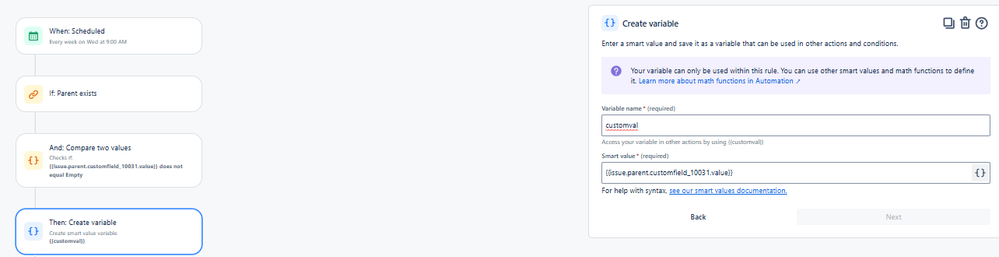

I have created a variable name: customval
Smart Value: {{issue.parent.customfield_10031.value}}
Here is the "edit issue" value I am using:
{"fields": { "customfield_10031": {"value": "{{customval}}"} } }
My branch is For JQL parent = {{issue.key}}
Then Edit the issue additional field:
{ "fields": { "customfield_10031": {"value": "{{customval}}"} } }
When this automation runs it returns successful, but only the community updates and not the entity#.
Thank you in advance for your help!
MG

Please post an image of your complete rule, of the edit issue action, and of the audit log details showing the rule execution. Those will help provide context for your question.

Please provide a screen image of your entire automation rule and all the details from the audit log entry from when the rule ran. Make sure that in the audit log entry you click all the ">" characters on the right to expand all the details of the entry.
