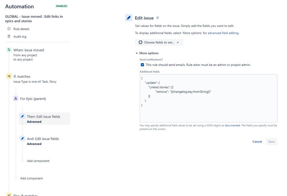

Hi Apryl,
I really don't know if it will work for your use case because the initial trigger is not the same. The "issue moved" trigger contains a changelog that can easily be accessed, and that is what I did as you can see below. You try to access this changelog after the event (not during it as I did). Maybe you should try to parse the issue history log with an automation rule to find the old key. I think that if you can see it on the issue history tab on the issue page, it can be accessed with automation.
If automation does not work, you can still try to access it with a JIRA api call in automation.
You can find below how I accessed the changelog with automation to retrieve the old key event if I think that will not help you.
Cédric
