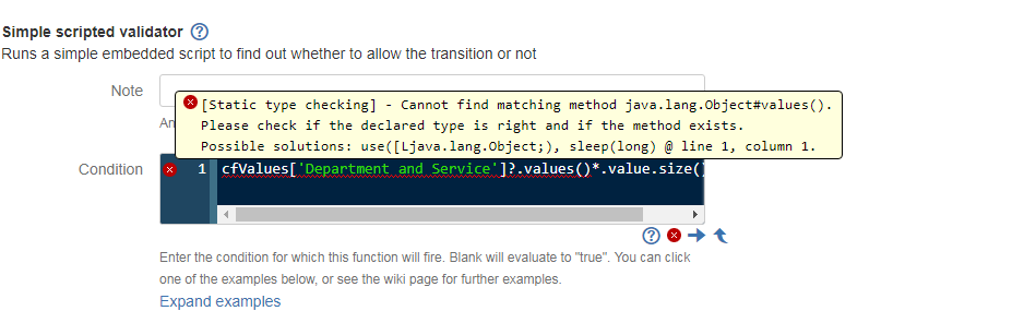

I use this Script
"cfValues['Department and Service']?.values()*.value.size() == 2"
and meet this Error. Please hepl
