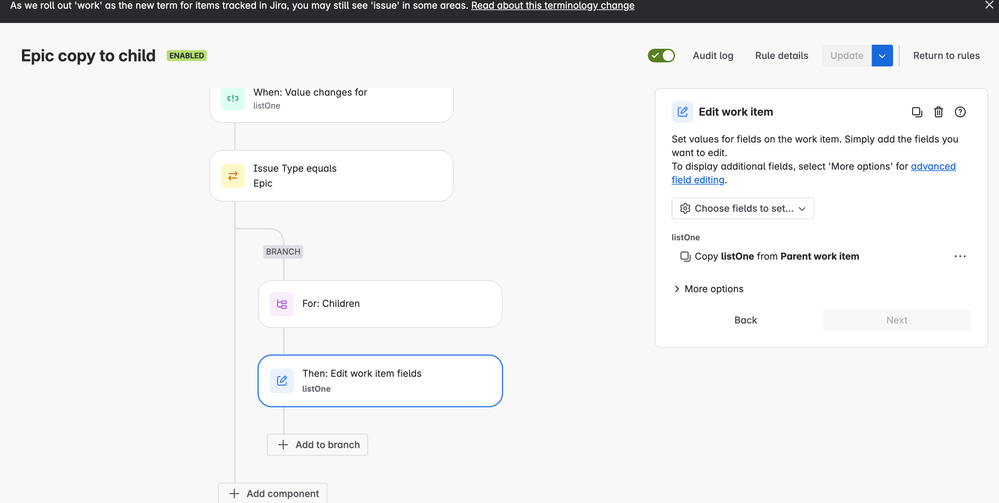

Use case - I am setting up an automation to update the Category field in the children of an epic when that same field is updated in the epic.

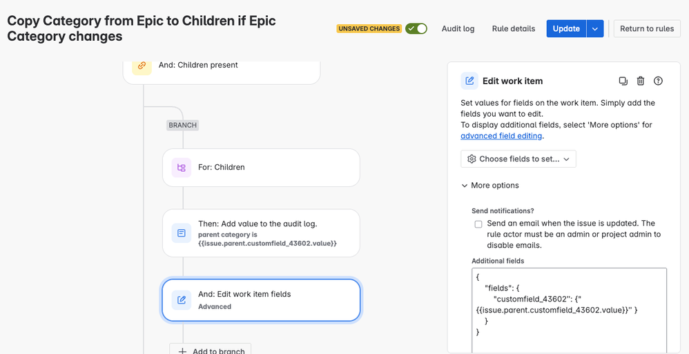

Below is a screenshot of the important bit of my rule but below are the variations of the JSON I have attempted.
"fields": {
"customfield_43602”: "{{issue.parent.customfield_43602.value}}”
"fields": {
"customfield_43602”: {"{{issue.parent.customfield_43602.value}}” }
"fields": {
"customfield_43602”: {"value": "{{issue.parent.customfield_43602}}” }
I have verified via log action that {{issue.parent.customfield_43602.value}} yields the desired value.

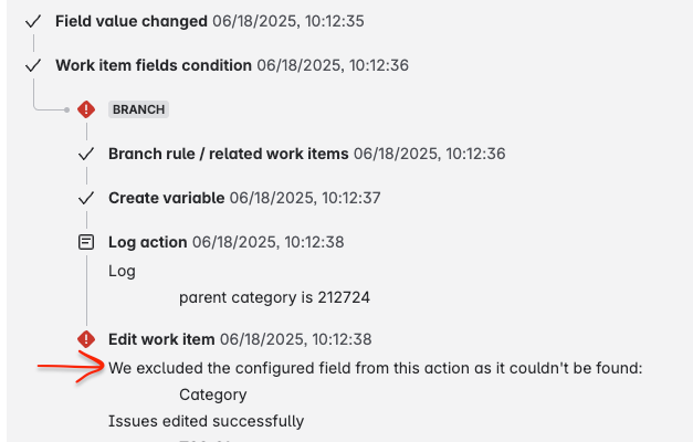

This WORKED! However, I do get an error that I need to understand...
and I just discovered this old post where the incredible @Mikael Sandberg offers the same solution. Maybe he can offer further context to understand when/why ID is required?

@Jack Brickey If my memory serves me correctly I believe I used this KB as a reference regarding the Category field. I had a similar automation that needed to set the category when a work item was created and at the time you could only use the ID for the value, but it looks like now you can also use the name.
@Jack Brickey I got the same error, when I forgot to remove the field from the Choose fields dropdown

@Maciej Dudziak _Forgappify_ , actually this does work and fundamentally answers my original question. What I was missing and did not initially see in your answer, due to me being heads down in using ID rather than value, was the ".value" within the smart value.
while i was simply using this...
"fields": {
I should have been using this...
"fields": {
"customfield_43602”: {"value": "{{issue.parent.customfield_43602.value}}” }
that was my stupid mistake!
