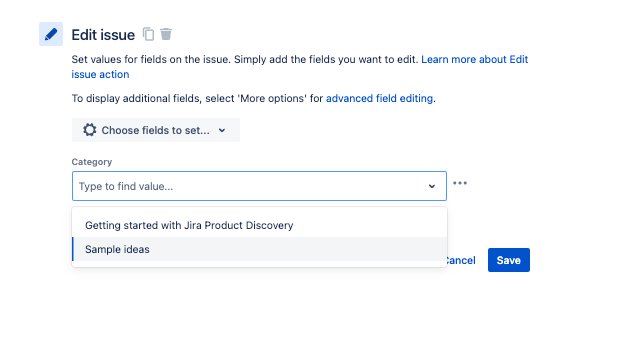

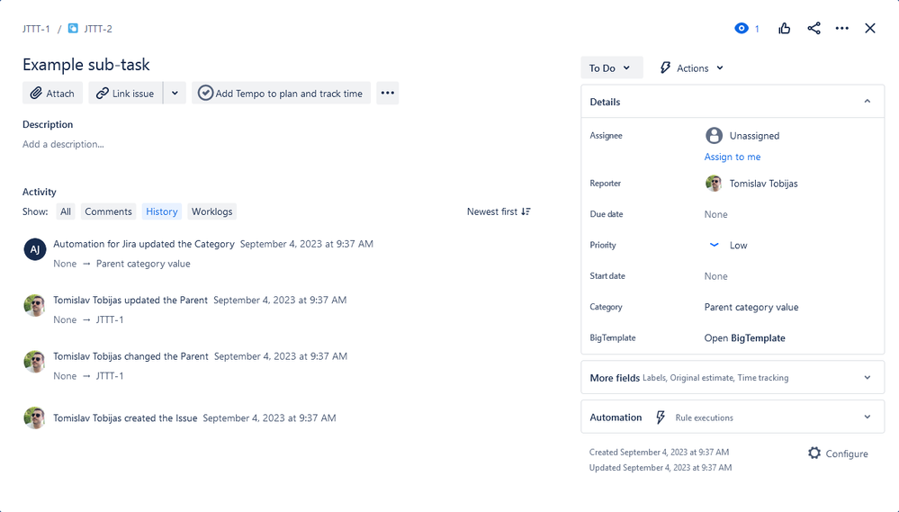

You can construct something like this:
You'll need to use Advanced fields section within Edit issue action and you can use the following JSON:
"fields": {
"Category": { "value": "{{issue.parent.Category.value}}" }
This should copy any "Category" value that is set to a parent issue (if it exists).

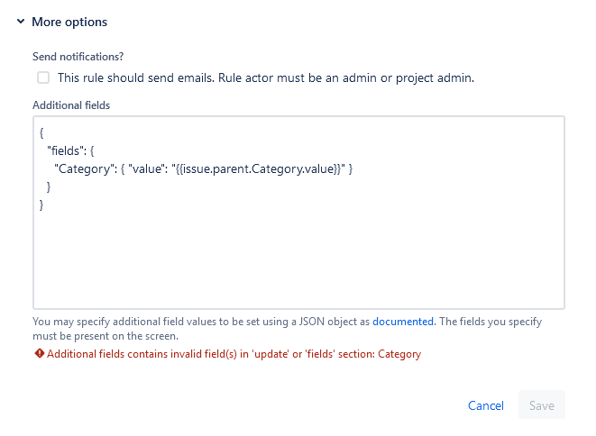

Hi all,

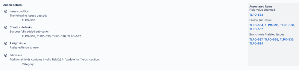

I am facing the same problem and when using the JSON, I get the following error message: Additional fields contains invalid field(s) in 'update' or 'fields' section: Category
I would appreciate some assistance with this case.

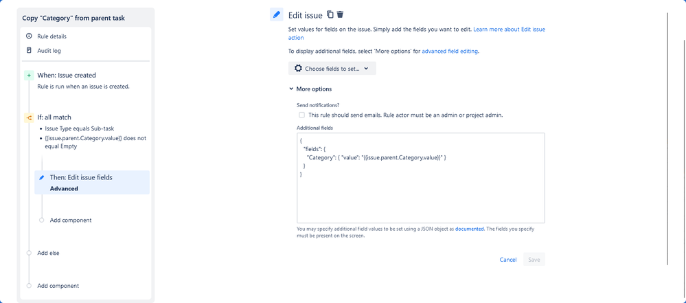

Can you copy Additional fields section content and maybe paste screenshots from the site and where the problem appears?
Also, can you confirm you're in business/Jira Work Management project? Additionally, from where are you creating sub-tasks?

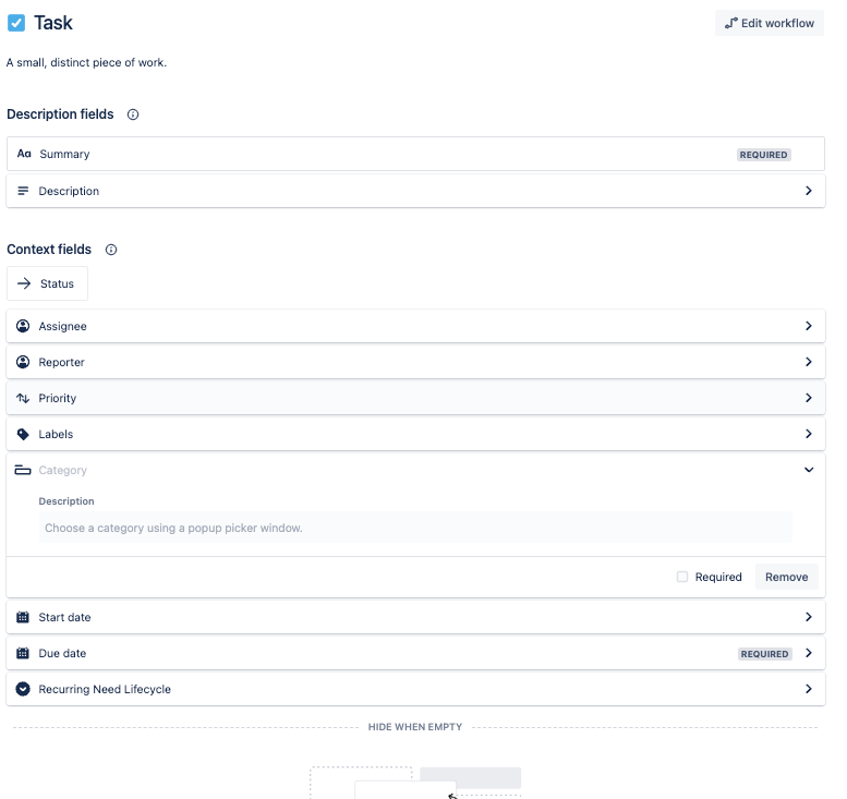

Yes, it's a Jira Work Management project and a team-managed project.
The subtasks are created by automation and both parent and subtasks contain the category field.
The only Category field I can choose is showing the wrong values, so it can't be the correct field.
I believe we messed up something with the field, but I'm unsure how to solve it.

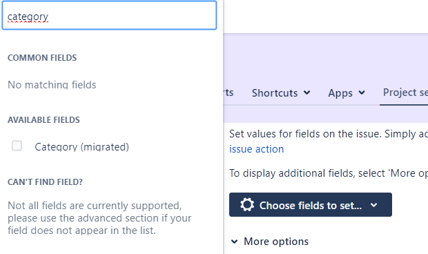

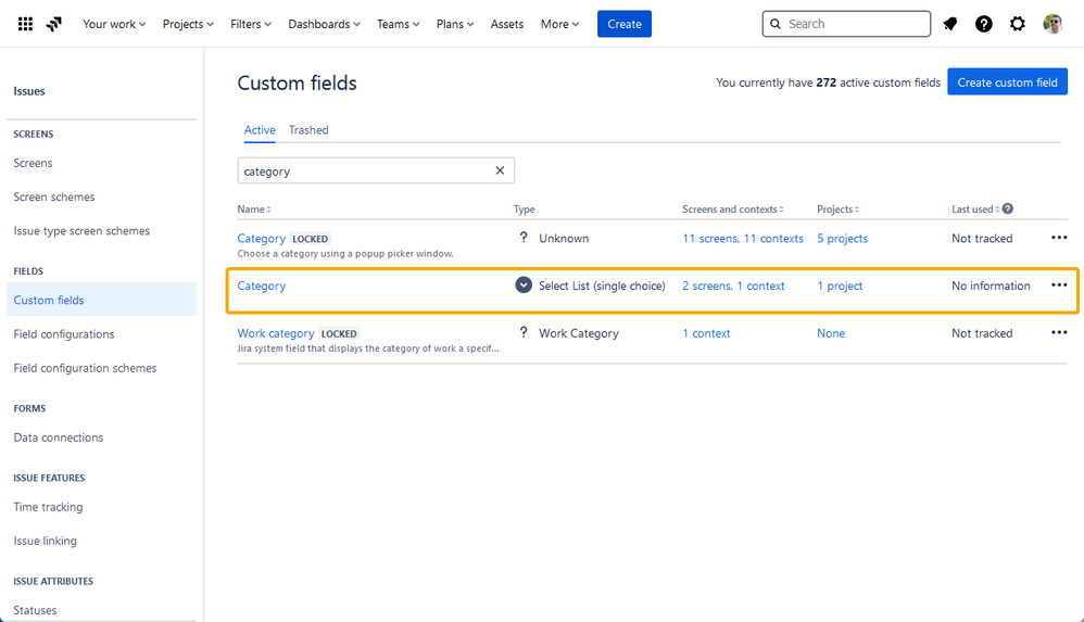

I think I've managed to replicate this error you're experiencing.
Basically, this might happen in case you have more than 1 field named "Category".
From the "Edit issue" action that you've attached here, I suspect that's the case (as you cannot, at the moment, select the system "Category" field from that dropdown).
Can you please navigate to Settings > Issues > Custom fields and check if that's the case? It should look something like this (note that the highlighted field is the custom field created by a user, and the one with "Locked" status is a system field):
In order to 'fix' this - to be able to use the provided JSON within the automation action, please rename all custom fields that are named "Category".
If that did not help, or if you mustn't/shouldn't rename those fields, I can try to find some other solution that actually uses system field ID instead of a name.

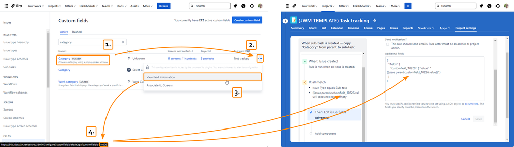

Then, you can basically use the following format customfield_ID instead of "Category" string/name.
To find the ID of the system "Category" field navigate to Custom fields page under Jira administration and search for the term "category", and follow the steps below:
Once you find the ID, go back to the automation rule and just replace "Category" string with customfield_ID where the ID is the number you've found in the step 4.
I've tested this by having 2 fields named "Category" in the custom fields list, and automation worked as expected. Also no errors/warnings were stated when trying to save/publish the rule.

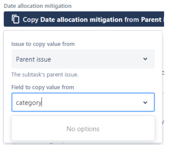

Hi @Fabio Racobaldo _Herzum_ ,
This video is helpfull but the category field in jira work management seems to be a special field.
I can't select it in the edit field action screen
please share a screenshoot about that field on creation
In jira work management i have the field category
i want to copy the category field from the parent to the subtask when a subtask is created.

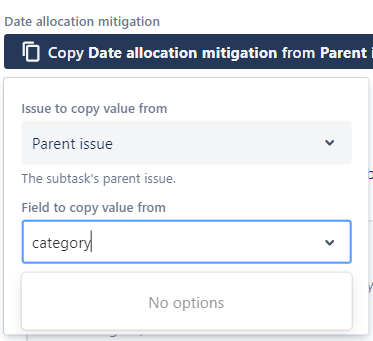

In the automation rule i create a branch
In the choose field to set the category field is not available
and it is also not available on the copy field from parent (for getting this i selected another field to try getting the parent field category
