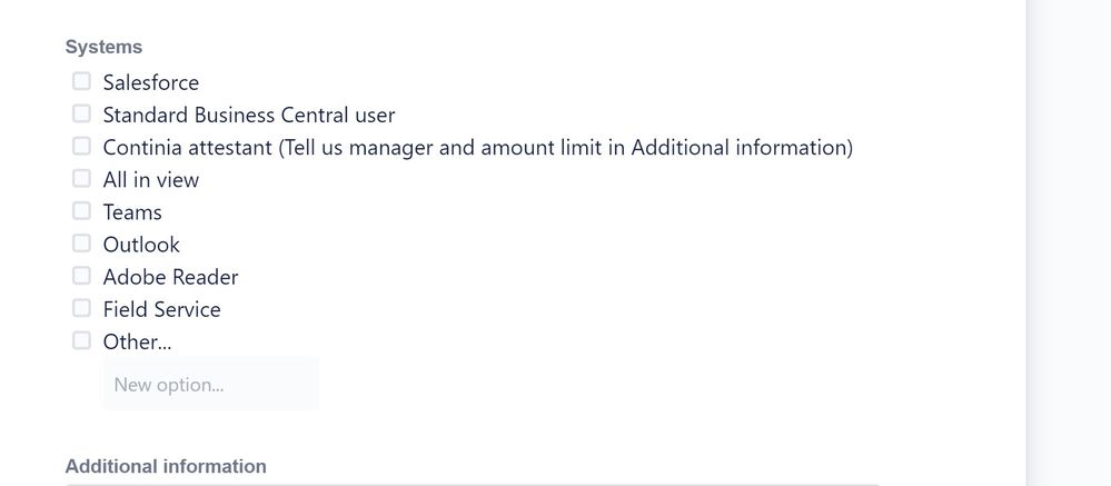

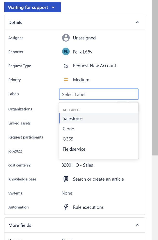

each checkbox CHOICES point to different label jira automation,
for example if customer choose Salesforce in ticket so open it will be choose salesforce label

It is for find tickets with label status and we need some statistic for this.

thank you very much, but i used Forms there for chechbox, do i need change this and create custom checbox field? because i cant see forms field to use in this list
Ah...that is an important bit of info. I do not believe Automation will support inspecting a form field unless that field is associated to an actual Jira custom field.
