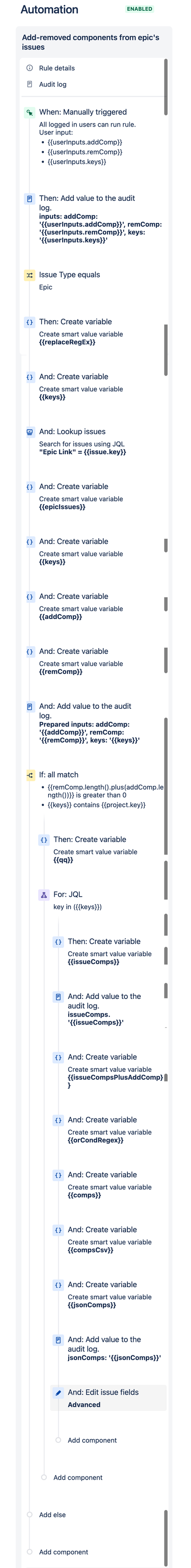

Great solution from @Bill Sheboy, but I think it is possible to remove components without creating a custom field. Interesting question @Michele D'Adamo actually I had to face a similar problem.
 Here is a more elaborated rule, based on my real scenario, which serves to add and remove components.
Here is the scenario:
  1. Create a manual rule with input values for adding components, removing components, and a set of issue keys.
  2. The rule will be running under a given epic and the mission is to adjust the components adding and/or removing them for indicated keys, if the input keys are not provided, then it takes all the issues that have as epic link the trigger issue.
  3. Inputs are processed to clean them, for example, extra spaces, duplicated commas, replacing semi-colon with colon, removing string delimiters, etc.
  4. The issue keys could have the project prefix or just the numbers. In the case of just numbers, it finds the project key and adds to them as a prefix, i.e. "XYZ-". Since most of the actions are project-specific, no need to enter a project prefix every time.
Here is the definition of the manual rules with the corresponding entries. We use some default values for testing purposes:
Here is the entire automation rule:
Let's see some specific settings:
{{replaceRegEx}}. This is what we use to add the project prefix to the input issues keys:
 {{project.key}}-$1
Clean and standardize userInputs.keys and set the variable {{key}}s:
{{userInputs.keys.trim().replaceAll("\\s*['\"]+\\s*","").replaceAll("\\s*[,;]+\\s*$","").replaceAll("\\s+", " ").replaceAll("\\s?[,;]+\\s?", ",").replaceAll("\\s?[\-_]+\\s?", "-").replaceAll("(?:[A-Z]+-)*([0-9]+)",replaceRegEx)}}
The last replaceAll is used for extracting the numbers adding the project key as a prefix and adding the dash. It works in both cases, then the issue numbers are provided (1,2,3, etc.), or the issue keys (XYZ-1,XYZ-2,XYZ-3, etc.). Since as per the documentation of replaceAll function only $1 can be used, the first group is not captured (?:).
Similarly, we clean and process the user inputs: addCom, and remCom, as follows defining the follow smart values:
{{addCom}}:
{{userInputs.addComp.trim().replaceAll("\\s*['\"]+\\s*","").replaceAll("\\s*[,;]+\\s*$","").replaceAll("\\s+", " ").replaceAll("\\s?[,;]+\\s?", ",")}}
{{remCom}}:
 {{userInputs.remComp.trim().replaceAll("\\s*['\"]+\\s*","").replaceAll("\\s*[,;]+\\s*$","").replaceAll("\\s+", " ").replaceAll("\\s?[,;]+\\s?", ",")}}
Look up issues. In the case case issue keys are not provided via input, then we use this {{lookupissue}} smart variable, as issue keys, for all issues that belong to the epic:
"Epic Link" = {{issue.key}}
{{epicIssues}}, is the string representation of all issues within the epic delimited by a comma:
{{#lookupIssues}}{{.}}{{^last}},{{/}}{{/}}
We define again the smart value {{keys}} (yes it is possible, you can define a variable with the same name more than once). Since smart values don't support if-else, it is constructed as follows:
{{#if(not(keys.isEmpty()))}}{{keys}}{{/}}{{#if(keys.isEmpty())}}{{epicIssues}}{{/}}
Idea taken from here: answer to this question Ternary operator (or if/else) with smart values from @Chad Waldman
Now we have all the input information to edit related issues.
If all match condition checks one of the addCom or remCom is provided. We check the length of each string. Since The if condition can only allow all matches or any match, to mix and or condition, we use the length of both inputs is greater than zero. The condition that {{keys}} contains the project key is just an additional check for the input keys, not going further if the issue keys are not specific to the current project or any failure in processing information.
The smart variable {{qq}} just has a single quote ("), we use it for appending the string delimiter.
We use Branch rule/related issues and the type of related issue is specified through a JQL:
 key in ({{keys}})
The variable {{issueComps}}, has all the components of the issue triggered in the branch delimited by a comma:
 {{#issue.components.name}}{{.}},{{/}}
The variable {{issueCompsPlusAddCom}} has the existing components plus the components to add:
{{issueComps.concat(addComp)}}
{{issueComps}} has a trailing comma, so we don't need to add it building  {{issueCompsPlusAddCom}}.
Notice, when we set the components Jira doesn't take into account repeated component names, so we don't need to exclude duplicates.
To remove the list of remCom from the previous variable, we use a regular expression {{orCondRegex}}:
({{remComp.replace(",","|")}}),?
 Replacing the "," with "|" we would get an or regex condition. The last portion is to remove the trailing comma in case it is present.
The variable {{comps}}:
{{issueCompsPlusAddComp.replaceAll(orCondRegex,"").replaceAll("(,+)", ",")}}
Removes all the remComp values from issueCompsPlusAddComp and removes any duplicated comma as a result of the deletion.
 The variable {{compsCsv}} converts {{comps}} variable with CSV delimited by string quotation (").
Now we have all the information we need to build the jsonComps variable:
{{#compsCsv.split(",")}}{ "name" : {{.}}{{^last}}} , {{/}}{{/}}}
Spit is used to generate a list, then we iterate over all elements adding the prefix "name : " and adding as a suffix "}," except for the last one.
Finally, using Advanced Issue Edit, we build the final JSON file as follows:
  "fields" : {
    "components" : [ {{jsonComps}} ]
We included some log instructions to trace the information. If you don't want to execute the last command and just debug the entire process without modifying the issue, just add a false condition before to visualize the information in the log without making the changes.
Even for components the Jira REST API JSON file allows add/remove actions, such actions can be applied for single values only, not for modifying an array of components to add or remove.
 Here is the log output:
The branch runs for two issues, to the log trace concatenates the information for each issue.
I hope it helps,
David

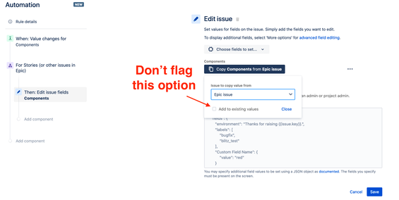

Petter Gonçalves
November 17, 2020 edited
Hello @Michele D'Adamo
Thank you for reaching out.
Indeed, Jira automation does not have a function to remove a component of a child issue (Stories, Sub-task, etc) when it gets removed in the parent issue (Epic or Parent task). We have the following feature request to get this function implemented on the rule triggers, so you would be able to use the Smart values to properly reference it in the rule actions:
Trigger rule when value is added/removed from multi-select type field
You can keep an eye on that feature request to check any updates.
If the child issues should have the exact same components as the parent issues, a possible solution would be to completely override the components of the child issues with the ones selected/removed in the Parent issue:
For more details, you can check the section "Add values to multi-select fields" of the documentation below:
Edit issue Fields
Let us know if you have any questions.
