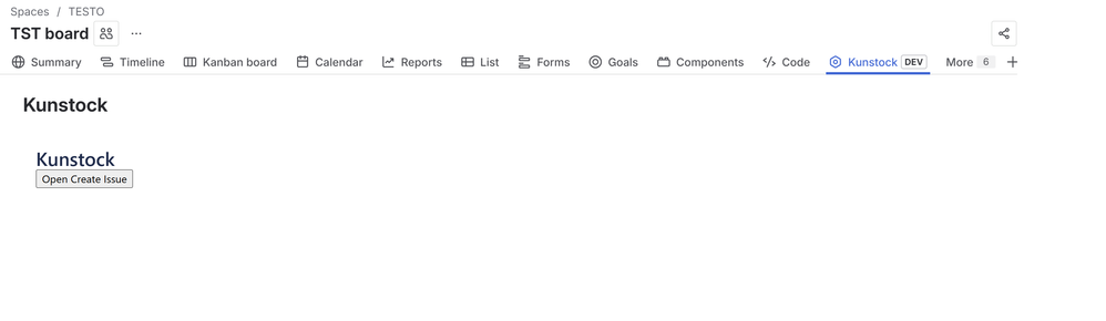

I've been investigating how you can do it, and I've created a tiny app just to show you how you can add a button to create an issue.

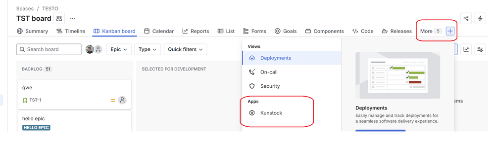

After I've deployed the new app created, I can see my app listed in here as I've selected "Jira project page" template, so a page in the Project page will be shown.
Then, after it was added, I can see the button that I've added as part of this example

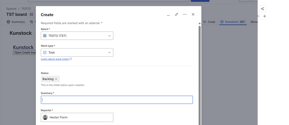

On which, if the user clicks on it, it'll open the create work item screen.
