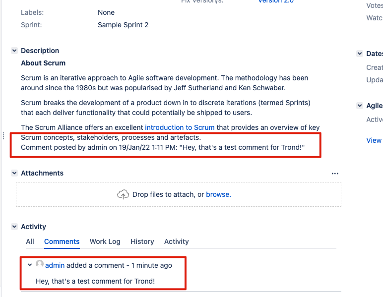

And the result will look something like this:

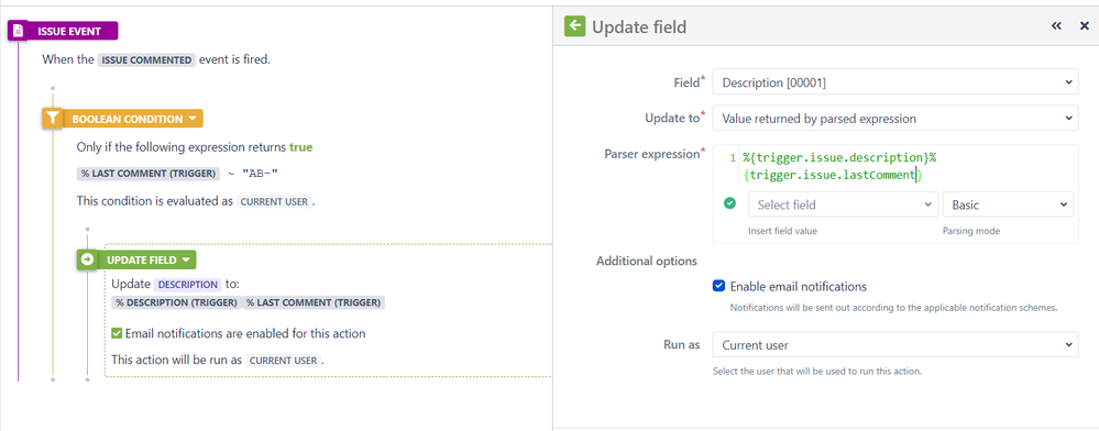

This is the first time I work with Jira, but I am quite certain we use Automation for Jira. I have added a larger screenshot that shows this.
We are using an on-premise version 8.8.0

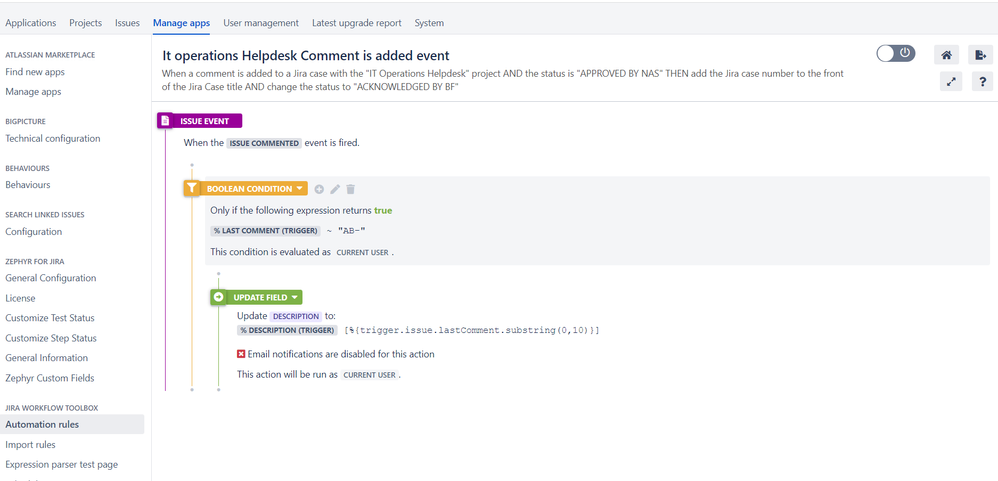

Here is the rule definition. In the final rule it will be string operations that will pick up the case number that always starts with "AB-" and add it to the end of the Jira case name.

Looking at your image, you are using the Jira Workflow Toolbox's version of automation, and not the Automation for Jira app.
