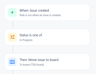

Hi @Dilli Babu You can do this using Automation Rules. Based on a condition or a workflow transition, you can move a specific issue to a development project and also assign to some user. Try something like this in the JSM project and let me know if it works :)

No documentation that  I can share, but do you have any specific questions? Were you able to try out something like the above screenshot?
