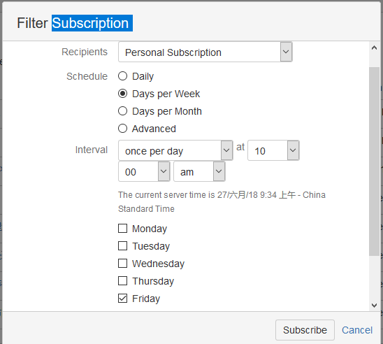

Hi @Stephanie Barlow,
You can user filter subscription according to the following configuration:
JQL:resolutiondate >= -7d
Hope this helps.

Hello @Stephanie Barlow,
I would suggest you set up a cron based Filter Subscription and you can get more info on this here : Constructing cron expressions for a filter subscription
Also, here's a simple Cron Schedule Expression editor to help set what you could need : https://crontab.guru/
Hope that will be of help :)
