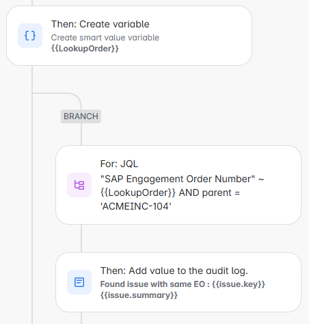

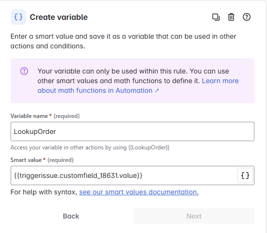

Step 1: Create smart value
I first create a smart value called {{LookupOrder}} which  contains {{triggerIssue.customfield_18631.value}}

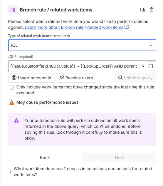

Step 2: Branch
Then within the branch step I am using this JQL Query:
{{issue.customfield_18631.value}} ~ {{LookupOrder}} AND parent = 'ACMEINC-104'
When I execute the manually triggered rule on the trigger issue I get this error in the audit log:
Branch rule / related work items05/07/2025, 17:08:04
Unable to find related work items. Try to only include work items containing links to related work items in your search:ACMEINC-104: "( ~ AND parent = 'ACMEINC-104') AND (key != ACMEINC-104)"
- Error in the JQL Query: Expecting a field name but got '~'. You must surround '~' in quotation marks to use it as a field name. (line 1, character 3)
What can I do to retrieve the work items with the same value in the specified customfield as in the trigger issue. How can I add some more JQL conditions, like the found work item key should be different than the triggerIssue - work item - key, and the parent should be a specific work item.

Ward Schwillens, Schwillie
May 8, 2025
Hi Jaime,
Thank you for your suggestion.
How do I need to mention the customfield?
Is specified this now in the JQL Branch:
{{issue.customfield_18631}} ~ {{LookupOrder}} AND parent = 'ACMEINC-104'
but I get this error now:
05/08/2025, 18:10:08
ACMEINC-104: "(000000500394 ~ 000000500394 AND parent = 'ACMEINC-104') AND (key != ACMEINC-104)" - Field '000000500394' does not exist or you do not have permission to view it.
Thank you for your insights!
Jaime Escribano _knowmad mood_
May 8, 2025
No worries! I can see where the confusion is coming from.
here just write the name of your customfield.
For example if the custom field was "description" the JQL would be:
description{{LookupOrder}} AND parent = 'ACMEINC-104'
If you notice, "parent" here is one custom field! And you are comparing it with a value. In the same way you want to compare your custom field to the {{lookupOrder}} value :D
Hope that helped!
