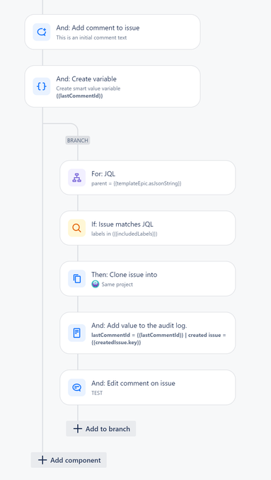

Here is that part of my automation:
Here are the parameters of certain actions from the automation above:

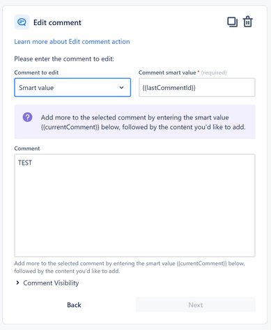

This is an example of an Edit Comment action with just a simple text "TEST" to illustrate that even that one is leading to this "No comment to edit" error:

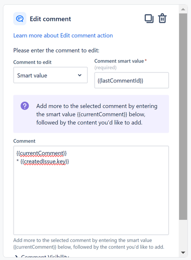

This is an original Edit Comment action, where I was expecting the initial comment to be updated with the list of the keys of the cloned issues:

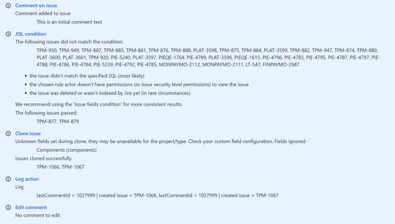

And here is what I see in the logs after running the automation (comment ID logged here is a valid one and it corresponds to that initial comment, which was added prior to entering the branch) :

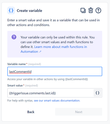

After adding the comment to what appears to be the trigger issue, the rule then creates a variable named lastCommentId to capture the id. But that is the last comment added from the time the rule triggered, and not from the last action. Please add a Re-fetch Issue action after adding the comment and before creating the variable to get the latest, last comment's id.
The branch on JQL is to a different issue than the trigger issue, and inside there is an action to edit a comment, referencing the saved variable...which is a comment id for the trigger issue's comments. The edit comment action is in the context of the "current issue", which in this case is the branched-to issue. I do not believe the action can arbitrarily access any comment as the REST API function does not support that.
I also thought so but it actually works like a charm without re-fetching :) I did quite a bunch of test runs while logging the value of this lastCommentId variable right after the Add Comment action and every time this variable was having an id of the newly added comment from that action right before the logging one.
