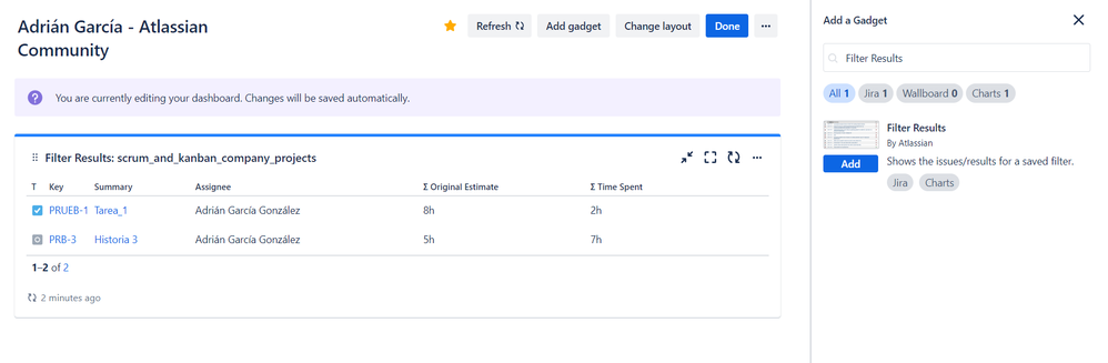

You can do original estimate vs time worked reports (regardless of whether you log work with Tempo or Jira log work) with a dashboard. Below I show you the steps to get to this report:
With this you will get an original vs. actual estimate report at the issue level with the project information and the assigned user.
If this option doesn't quite meet your needs because you want the data to be aggregated and grouped by project and assigned user you will have to opt for a plugin, I recommend Dashboard Hub, which is very easy to use and allows you to do the same, with its JQL Custom Charts gadgets.
