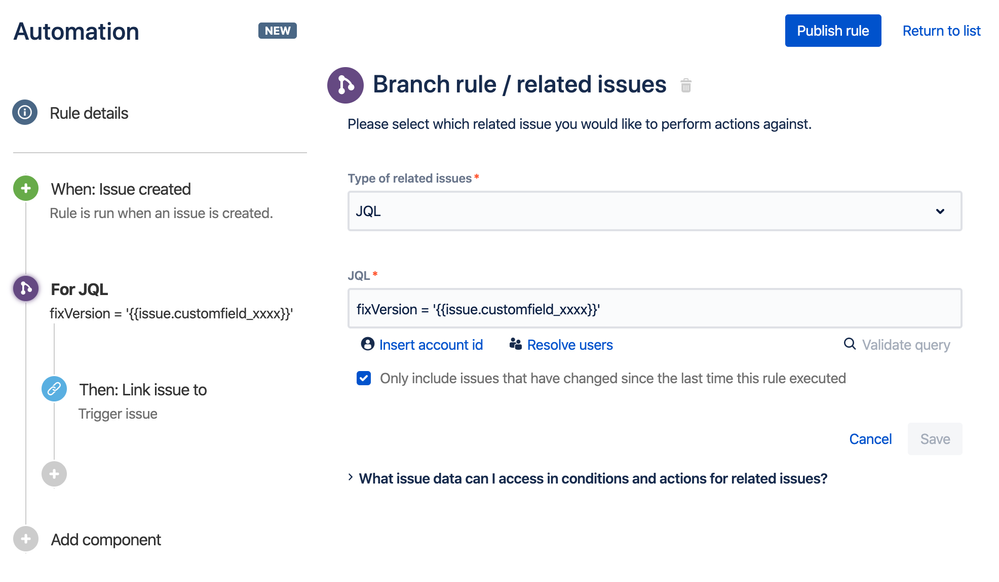

Hi Esther,
Okay, so if you're going down that path then it is fairly straightforward. I'd be doing this at issue creation and an example of how you might tackle this is:
s1.pngs2.pngSo the rule is triggered when an issue is created. We then use the branch on JQL to find all issues with a fixVersion same as that entered into the custom field. You can see that I've used smart values to reference this field. You can just use the field name rather than the customfield id, I just didn't know the field. Once we've branched onto these issues we just want to link them to the issue that kicked things off so we use the link action with trigger issue.
You may need to add some project restrictions but hopefully this should get you started.
