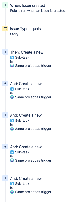

We have stories set up to automatically create subtasks for our process and this has worked great. However, I am trying to set up automation so when these are set up, they automatically link all subtasks within that story, so it is easy to move around whichever subtask you're in.

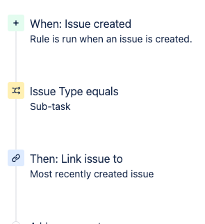

Happy to add to this existing workflow or create a new one. I have been trying to set it up with a new one, but get stuck at the linking issues as there is no option to link with sibling tasks

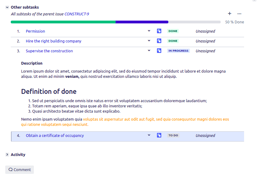

Therefore, if you are fine with a marketplace app, we have created Subtasks Navigation app to view your sibling issues and their description without loading the entire parent nor using the filter. This might be a good addition to your toolkit as it allows you to easily move around the sibling subtasks of a certain story with a new panel called Other Subtasks (view the picture below)
Disclaimer : I am part of the team which developed this app
Subtasks Navigation for Jira
