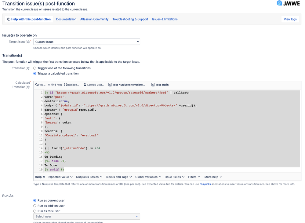

since you want to trigger one transition if the REST call succeeds, and another transition if the REST call fails, the easiest is to use a single Transition Issue(s) post function and use a calculated transition, based on the result of the REST call.
The Calculated Transition script is:
{% if "https://graph.microsoft.com/v1.0/groups/:groupid/members/$ref" | callRest(
verb="post",
dontFail=true,
body= { "@odata.id": ("https://graph.microsoft.com/v1.0/directoryObjects/" +userid)},
params= { "groupid":groupid},
options= {
'auth': {
'bearer': token
headers: {
"ConsistencyLevel": "eventual"
) | field("_statusCode") != 204
To Pending
{%- else -%}
To Done
{% endif %}
Note that field("_statusCode") != 204 is a little fake, as in reality _statusCode will only be returned in case of an error. So basically you could just test field("_statusCode") != null
Also note the added dontFail=true parameter.
"To Pending" is the name of the transition that needs to be triggered if the REST call fails, and "To Done" is the name of the transition that needs to be triggered if the REST call succeeds. Ideally, you should replace them with transition IDs (numbers) instead of names, in case you later rename the transitions.

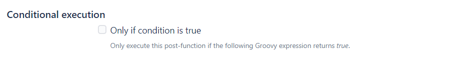

In this case, you will need to have multiple post-function calls (i.e. multiple "Transition Current Issue Post-function" setup) and within those calls use "condition execution" setup - One for "Done" and other one for "Pending"
The key is to have a custom post function that will populate a field with the "200 aka" value prior to your ""Transition Current Issue Post-function"" calls. So your JMWE post function for the WF transitions can detect the return value.
