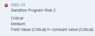

  • The first value from the bottom is "Risk probability" custom field of type Select List (single choice)
  • The second from the bottom is the "Risk consequence" custom field of type Select List (single choice)
  • The last value from the bottom is the result of the calculation formula at the top. I cannot seem to get it to validate true.

David Fischer
August 2, 2017
this is likely because you are using the "==" operator to compare Strings. This would be valid in Groovy, but in Java (and BeanShell, which is derived from Java), the "==" operator returns true only if the two operands are one and the same. To test for String equality, you must use the equals() method:
"a".equals("a")
returns true, but:
"a" == "a"
returns false (because the two strings are two different Java objects, even though they contain the same characters).
Ben August 2, 2017
Thank you David for calling that out, very much appraciated!!!
