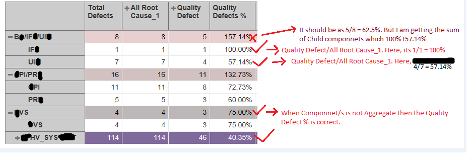

Hi Professionals,
I am building an EazyBI report where I have Project in Row and Custom field "Root Cause_1" in Columns. Now the dropdown value of Root Cause_1 are Aggregate(total), similarly Components in Project are Aggregate.
The issue I have is When I want the "Defect Quality %" in Parent Component/s, I am getting the sum of each somponent/s. How do I get the % at the parent level?
The screen cap to cover the description is attached.
Please assist.

All mathematical calculations including percentage calculations should be done in "Measures" (not in any other dimension).
It seems this report lacks any measure and it leads to unpredictable results.
Suggestion from T S gives you a right direction how to create percentage (%) measure.
If you still need more detailed assistance, please contact support@eazybi.com and send your exported report definition.

What does your code look like?
Have you tried using a case statement for when the current member is the parent? Something like the following:
CASE WHEN [Time].CurrentHierarchyMember IS
  [Time].CurrentHierarchy.DefaultMember
THEN 1
ELSE
  [Measures].[Issues created] /
  ( [Measures].[Issues created],
    [Time].CurrentHierarchyMember.Parent )
END
