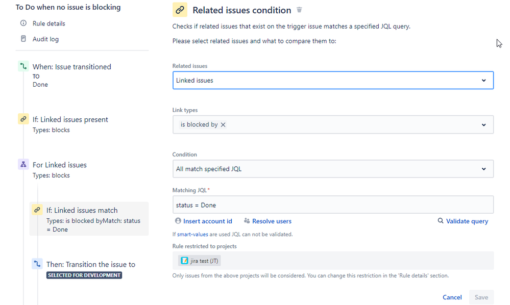

Hi @fulya
These are my suggestions if I got your requirements right:
  • #1:
    • given: issue link of type "blocks" is created
    • when: blocked issue is not in done or backlog
    • then: transition issue that was blocked to backlog
  • #2:
    • given: issue is transitioned to done
    • when: condition that this issue blocks another one
    • then:
      • identify the issue(s) that are blocked by the triggering issue
      • check issue(s) that were blocked if there are still other issues blocking
      • if not --> transition to "To Do" (in my example "selected for development)
Hope I got your requirements correctly and this helps.

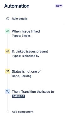

Josh Costella
February 24, 2022
Hi @fulya
You won't be able to accomplish what you are trying to do with just JQL. You would need to use automation.
Here is a quick example of what you can do to accomplish what you are looking for. This would take care of the Backlog move.
