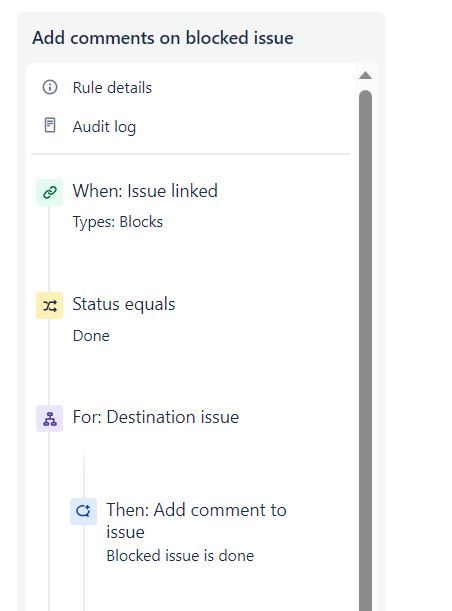

I want to write an automation rule so whenever the blocked issue (linked issue) status is Done. then need to add a comment on the destination Issue.
The below rule isn't working for us.

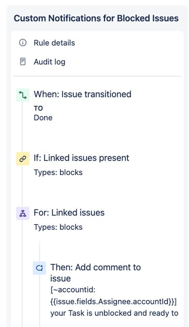

I am doing something like this in an automation in my org, except I am not triggering my rule on the linking, but instead on the transition to done. To follow my implementation you will want to arrange it a bit differently than you have it above.
I am triggering on the transition, then making sure there is a linked issue with the blocks type. Lastly, for the linked issue with the blocks link type I am adding a comment and mentioning the owner.
Here is a screenshot of mine:
If you want the rule to fire when the issue is linked, I think you could still use my screenshot above, but replace the When: Issue transitioned with When: Issue Linked
Here is what I am using to mention the owner in case it is helpful: [~accountid:{{issue.fields.Assignee.accountId}}]

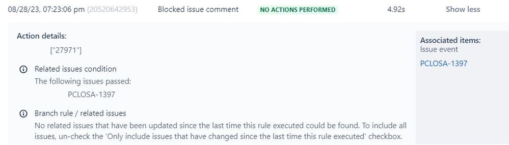

This rule is working fine. but if one issue has two blocked issues let's say Issue-A has two blocked issues Issue-B and Issue-C. if Issue-B is done comment getting added but when Issue-C is done comment not getting added again.
I tried checking this but still not working and I got this in the audit log.

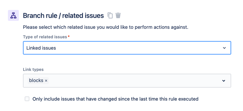

@Akshithrekulapelli apologies my last comment was confusing, you want that unchecked.
When it is unchecked, what are you getting in the logs for Issue C?
it is working fine after uncheked. How can we add ticket number in comment? lets say SUP-11 is done, in comment we need to add SUP-11 is done
