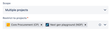

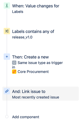

In the meantime you could link the issues in a separate action. I would set the scope in the rule details to the projects you're linking between.
Your rule might look something like this:
