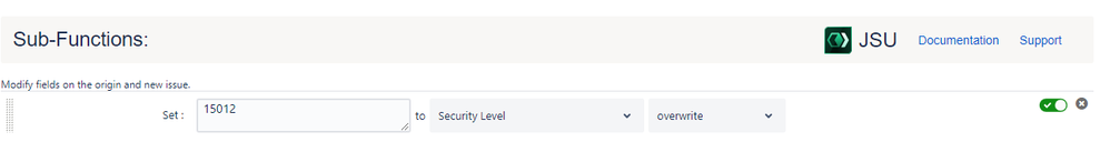

During a state transition in my project A,  I'm trying to create a new linked issue using Create A Linked Issue (JSU) Function in my Project B.
Project's B issues have security level set as mandatory,
I've tried setting it by ID and name, but none of it works
Unexpected error occurred during create issue! (original Issue: XXXXX-00000) [Validation failed! [security: Security Level is required.]]
How can I create a new Linked issue using Create A Linked Issue (JSU) Function when the security level is mandatory?

Hi @Gaston,
For the Security Level field, name should be used instead of ID here. Perhaps the level name is tricky and contains some spaces that you are missing?
To check if the name is correct, try the following:
  1. Go to Project settings > Issue Security.
  2. Click on the button Actions and select Edit issue security.
  3. Click on Edit near the level you want to use. Check the level name. If it differs from the one you used, correct it in the workflow post function.
Let me know if it works.
Gaston December 13, 2023
Thanks, the problem was that some issue security level had whitespaces at the end, and JSU removes them when copying.
