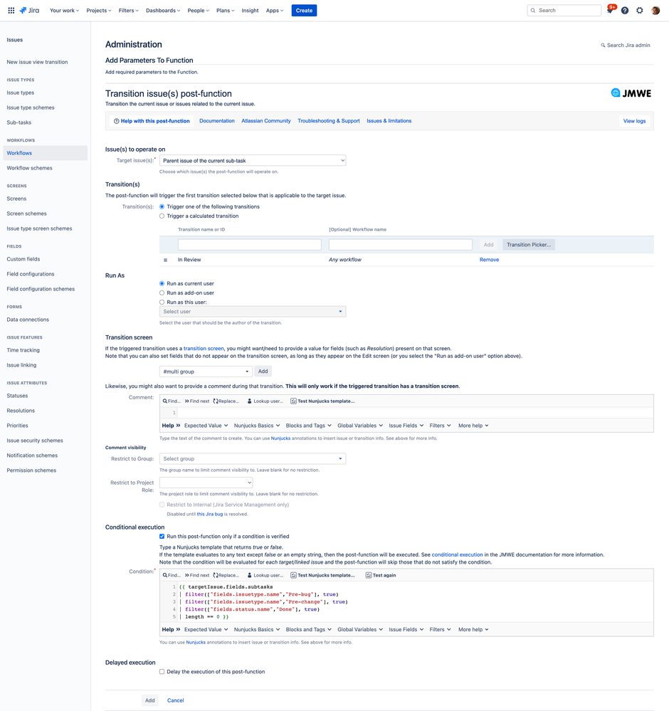

you can use a Transition Issue(s) post-function on the sub-task transition(s) to "Done", configuring it like this:
- Target Issue(s): Parent of the current sub-task
- Transition(s): add the transition that takes the parent issue from In Progress to In Review
- Transition screen: add any field that should be set on the parent issue - this is required if the transition to In Review requires certain fields
- Conditional execution: check the checkbox and use this script (which you'll need to adjust to your sub-task issue type names and done status name - everything is case-sensitive):
{{ targetIssue.fields.subtasks
| filter(["fields.issuetype.name","Pre-bug"], true)
| filter(["fields.issuetype.name","Pre-change"], true)
| filter(["fields.status.name","Done"], true)
| length == 0 }}
screencapture-jmwe-dev-local-atlassian-net-secure-admin-workflows-AddWorkflowTransitionFunctionParams-default-jspa-2022-02-16-14_02_34.png

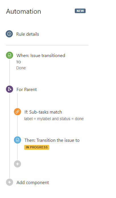

Dave Bosman [Realdolmen]
February 16, 2022
Hi @Janaki.R
You can do this with these instructions
Keep in mind that you will need to create a small script to do the conditional check.
Another solution could be with automation for Jira. A simplified example of what you would need is the following.
