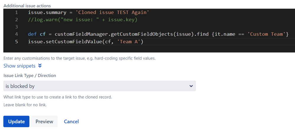

When project TEST, any issue type, transitions to "In Progress" and custom field "Dropdown Field" = Option 1, there is a post function to "Clone an Issue, and Link".
Under "Additional actions", setting a custom field on the new issue returns as 'null' and does not set the custom field value. Yet, it works when using setting issue summary.
When I try to use issue.setCustomFieldValue, the logs return property id on null object. When I ONLY use issue.summary, the issue properly gets created and linked. When I try to add a log.warn, it returns the issue as null.
I've also tried "doAfterCreate" from this page and got "no signature of method" error.
Any reason why "issue.summary = 'blah'" works yet "issue.setCustomFieldValue(cf, 'value')" will not?

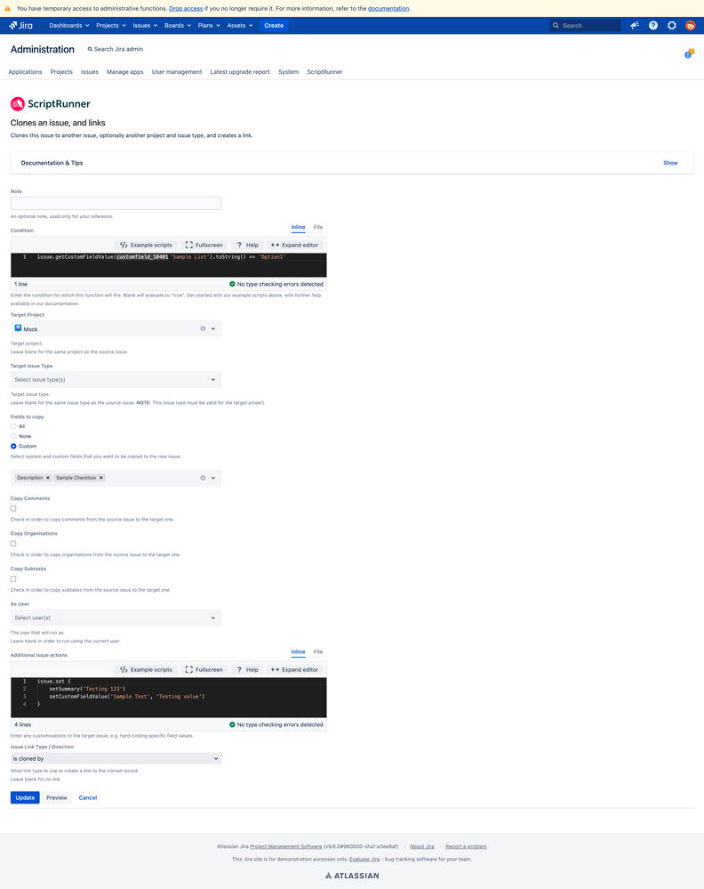

Below are the sample codes that I have tested with:-
1. For the conditions:-
issue.getCustomFieldValue('Sample List').toString() == 'Option1'
2. Additional issue actions
issue.set {
setSummary('Testing 123')
setCustomFieldValue('Sample Text', 'Testing value')
Please note that the sample codes above are not 100% exact to your environment. Hence, you must make the required modifications.
Below is a screenshot of the Post-Function configuration:-
If you observe the sample above, I am using ScriptRunner's HAPI code format on the Condition as well as the Additional issue actions code.
In this example, I have set the Post-Function to the In Progress state and configured the cloned issue to be linked as is caused by link.

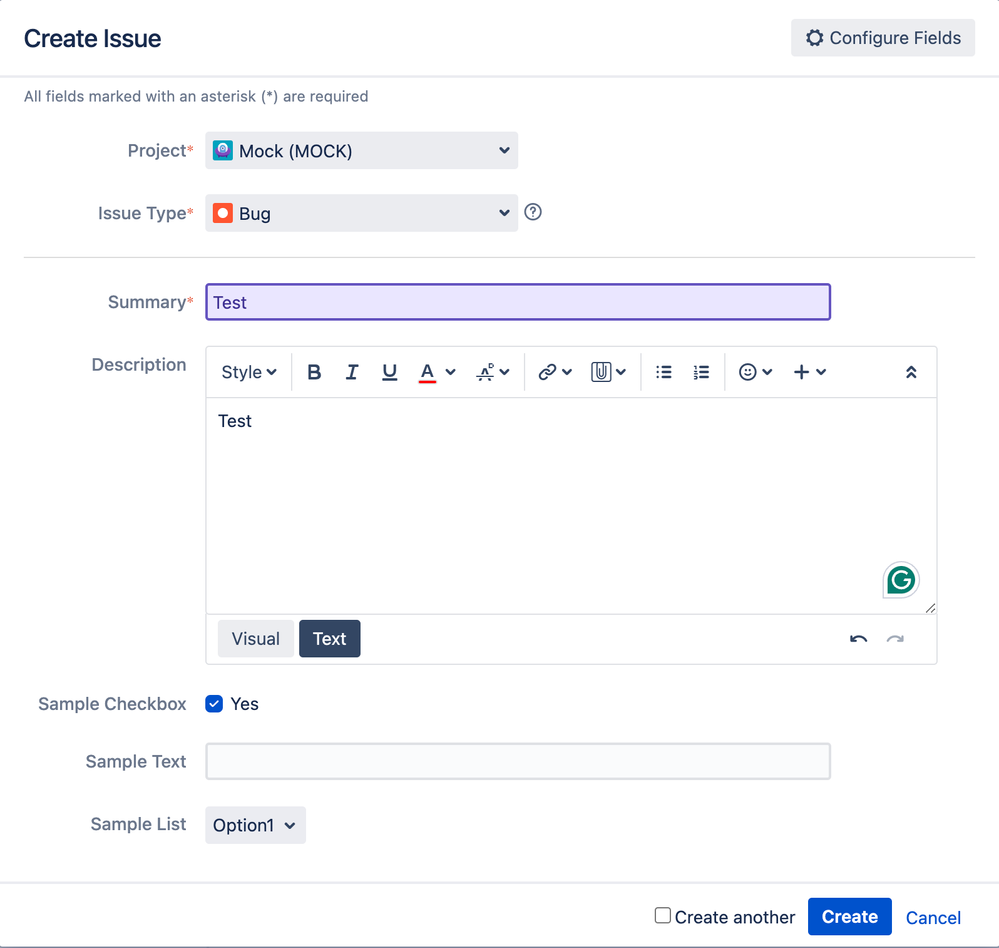

1. On the create screen, I have added some values for the Description, Summary, Sample Checkbox and Sample List

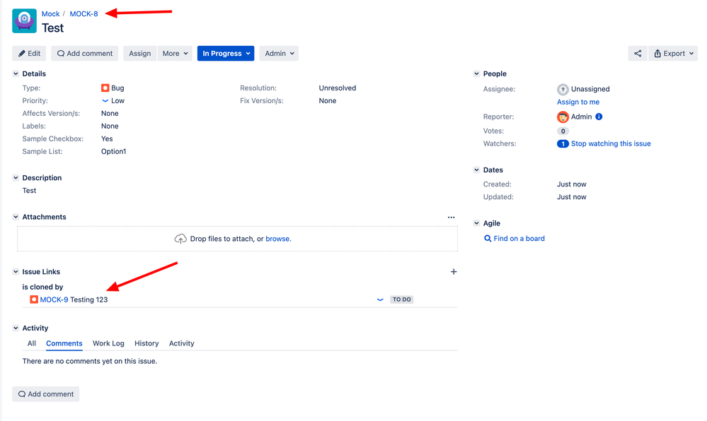

2. Below is a screenshot of the issue that has been created

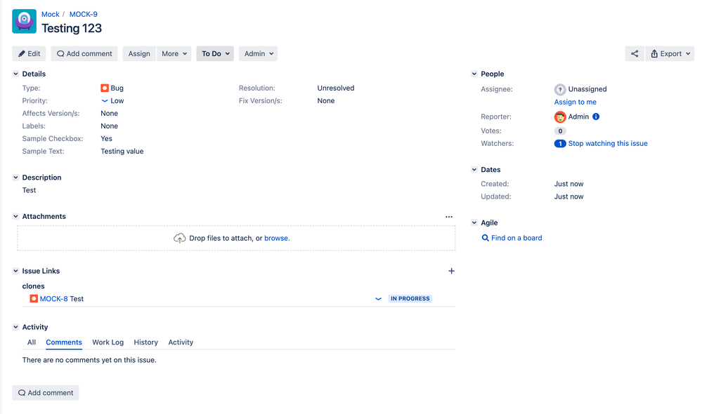

3. Once the issue transitions to In Progress, as expected, the Cloned Issue is created with an updated Summary
4. Below is a detailed view of the Cloned issue.
