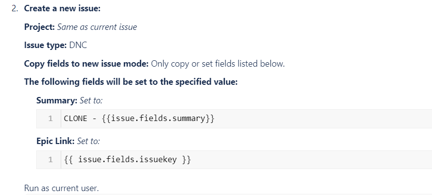

Hi @Alex Koxaras _Relational_ thanks for your reply, this line really helped - What you want to do is to copy the Epic's key to the child's epic link field
I did the following:
1. Manipulate the issue workflow via subtask transition
2. Manipulate the epic workflow via issue transition
3. Set the epic link field value for issue1 to epic key
4. Set the epic link field value to copy from the current issue when the transition is making a new issue
Sound complicated but for me, this is a perfect solution.

  1. First of all let me clarify that Epic Name exists only on epics. What you want to do is to copy the Epic's key to the child's epic link field

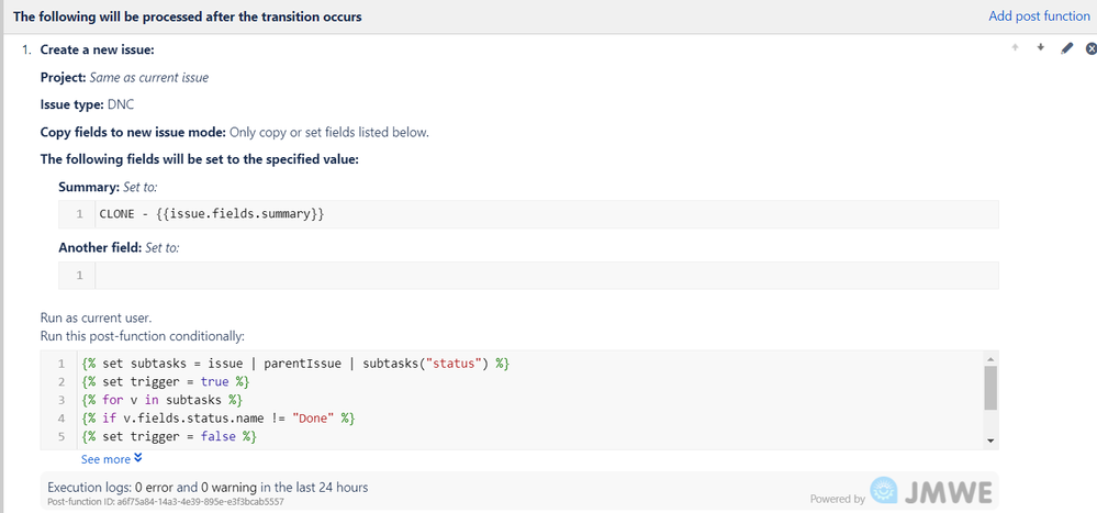

  2. For this request to work, I would suggest to create firstly a field (name it e.g. EpicLinkSubtask) which will hold the value of the epic key. Keep in mind that Epic - Subtask relationship does not exists. So you have to pass the Epic Link value of the Issue1 to the Subtasks(1,2,3).
    Then you would have to add a condition to that rule such as the following
    {% set subtasks = issue | parentIssue | subtasks("status") %}
    {% set trigger = true %}
    {% for v in subtasks %}
    {% if v.fields.status.name != "Done" %}
    {% set trigger = false %}
    {% endif %}
    {% endfor %}
    {{trigger}}
    The above rule will be added to the done transition of your subtask
