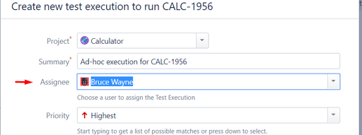

Question 2: All my test cases and Test Sets are currently assigned to a tester. When I create test Execution, and include Test Sets, the assignee field becomes unassigned. Is there a way to retain the assignee field and keep it unchanged when we create Test Execution?

Question 2: When creating the test execution, you can select there the user that is going to be assignee:
