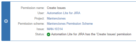

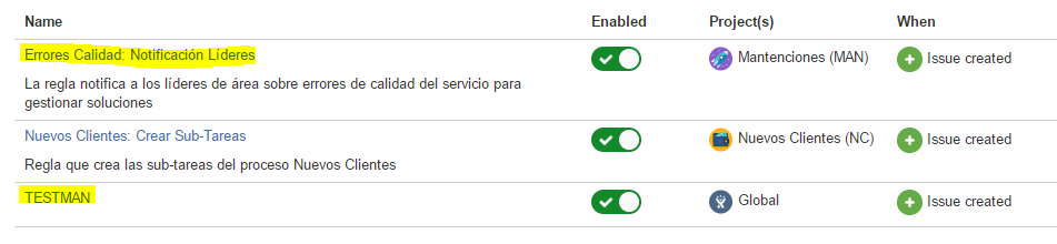

Fabrizio del Mauro
April 12, 2017
Hi Andreas,
I have had problems when try to excecute the almos-the-same rules between diferent projects.
The autobot is an Administrator in hour instance and in the respective projects with permissions.
Projects whereas the rules don't work
Can you help us, please?
Thanks!
andreas
April 12, 2017
Hey Fabrizio,
Can you raise a support request at https://codebarrel.io/support please with some more details?
Can you include screenshots of your audit log showing rules that didn't execute please?
Can you also include screenshots of these rule configurations please?
Finally are your workflows using custom events?
Cheers,
 Andreas
