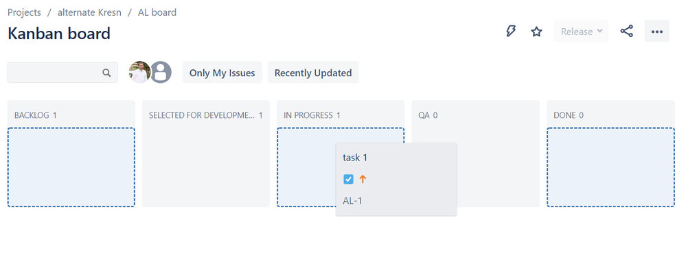

for some reason, i cant move issues from one column to the other, and i have no idea wat to do what this message box is telling me to do. Anyone have an idea?

I created a new project and added a new column. Im having the exact same issue. My tasks will NOT go inside of the new column UNLESS i go into the issue and change its column location manullay.
First, you shouldn't be setting a Resolution on the QA status - Resolutions are for final adjudication of the issue. I don't know that what is actually causing your problem, but I would try that first - taking off Set resolution for QA.
