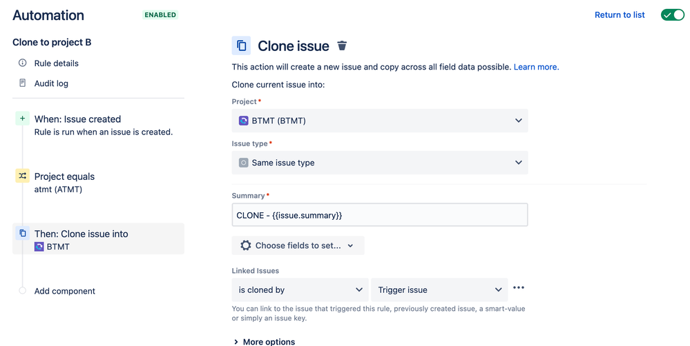

1st Rule: Clone to Project B
When: Issue Created
If: Project equals Project A
Then: Clone issue into Project B
  • Define an issue link type that will be used in 2nd rule

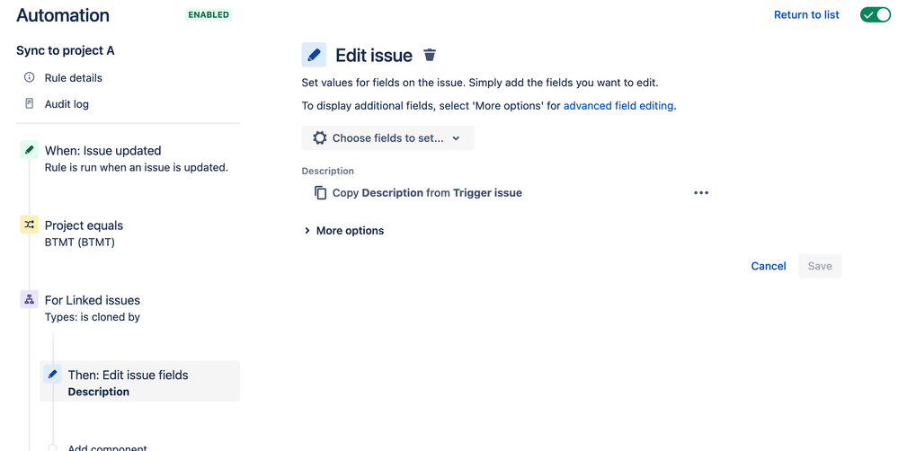

2nd Rule: Sync to Project A
When: Issue Updated
If: Project equals Project B
Branch rule / related issues: Linked issues Types: <linking issue type from 1st rule>
Then: Edit issue Fields  <Copy from Trigger issue>

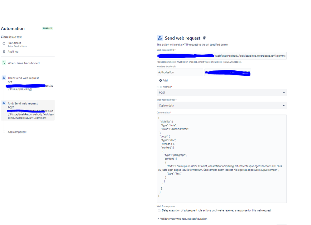

Teodor Hoza
October 18, 2021
The only issue is that it won't allow me to run this, as I'm trying to avoid creating global rules, so I went for the HTTP REQUEST approach which suits me better but the downside is that I will have to make clones of this automation rule.
However Alex, your approach is very useful, therefore I will accept your answer!
