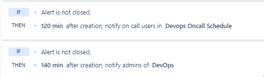

You can add an rule in the same escalation rule, to alert again if the alert is not closed after some time
But there is no way to notify the owner of the alert in the options.
In this case, I suggest you to notify the team leader if not closed, or the team - if the main problem is closing the alert anyone can do it if fixed, right?
