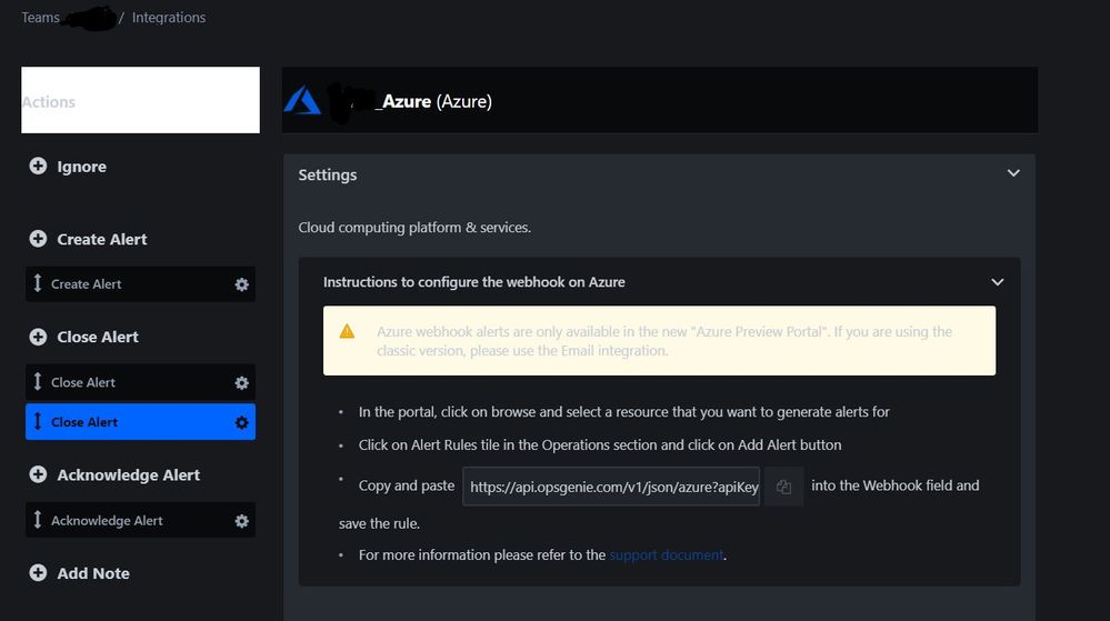

I notice in the Opsgenie Azure Integration section there is a configuration for close. please see attachment.
is there a way to configure the above API in the Opsgenie close section of the integration ? reason being in the integration guide, Azure post of the requirement parameters to Opsgenie.

Some of out integrations, like Jira, have built-in mappable outgoing actions. Meaning actions can be taken on the Opsgenie alert - such as close - and reflect on the Jira issue so change the status, add a comment, etc.
Unfortunately Azure does not have this prebuilt functionality. An alternative that might work is our webhook integration. This can be used to POST back to an endpoint when an action is taken on an Opsgenie alert:
https://support.atlassian.com/opsgenie/docs/integrate-opsgenie-with-webhook/
But I can't for certain say this will work since I don't think we've come across this with other customers.
