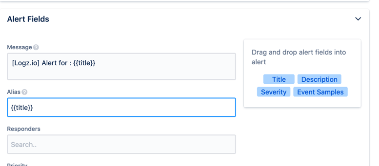

For 3rd party integrations like logz.io, Opsgenie does not control the payload format being used. While you can "mock" a specific request using the integration's field (as you did in your post), the way those fields translate onto the alert is mostly determined by the integration settings:
So if you want to use this method to set an alias in the logz.io integration, what you'd really need to do is set the fields that make up the alert alias according to the integration settings in Opsgenie. That is, make sure the alias is set in the integration settings, then set the fields that make up the alias in the payload to Opsgenie.
Does that help clarify why the request you sent wasn't setting the alias?
