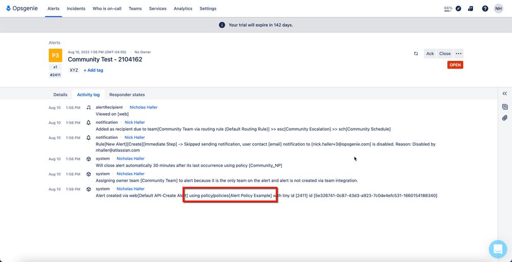

This leads me to believe that there is some workflow configured in your Opsgenie that is adding these additional teams - such as an alert policy. These are used to modify alerts, and can be configured on a team level, or globally. Since the team is new, I would assume the Watcher Test team does not have any policies configured.
If possible, check some of these recent alerts and the activity logs. If any policies are being applied, they'd appear like so:
If that's the case, review the alert policies because one (or more) could be adding these additional teams to the alert at creation.
If that's not the case, the alert's activity logs might still provide some insight into why these additional teams are being added.
