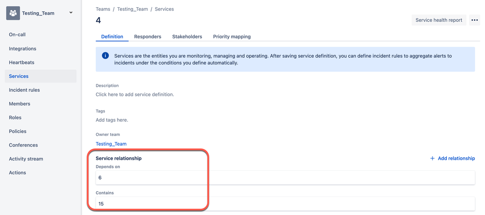

Hi @Stefan Draber ,
You can actually see the service relationship both ways, as long as services are assigned to team. You can view the relationship from the 'services' page on the team dashboard. Here is an example:

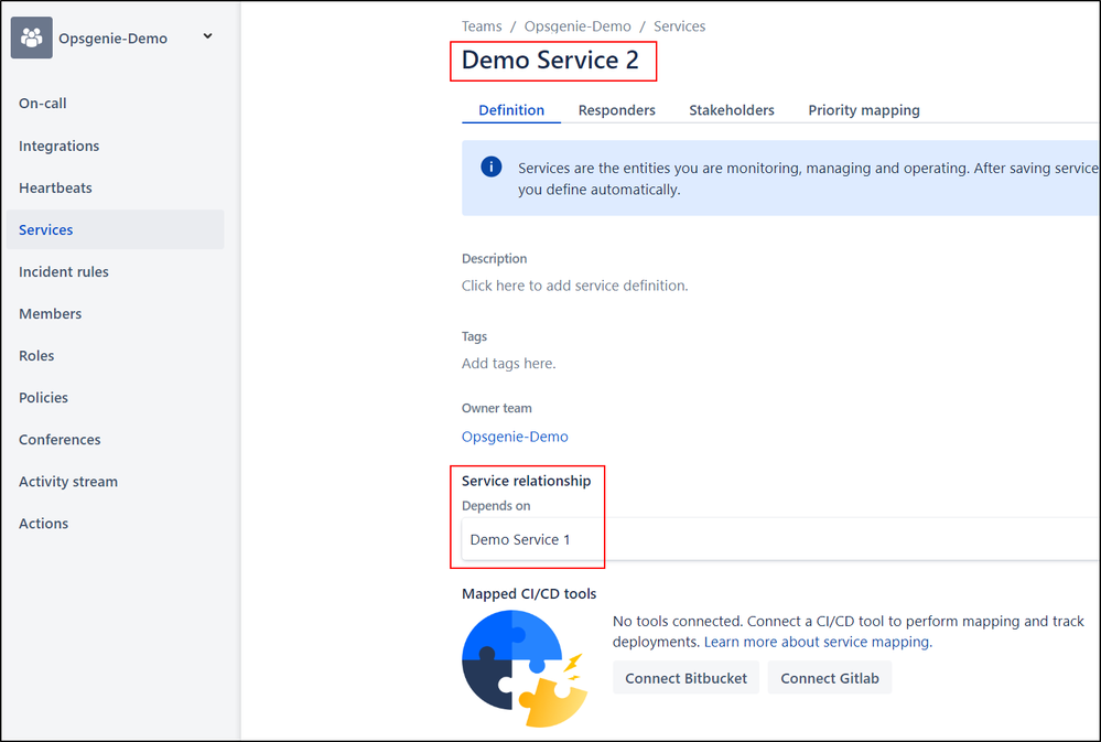

Hi @John M
thanks for your feedback, unfortunately I cannot confirm for my instance.
I have a demo-configuration where Service 2 depends on Service 1. This is shown on the Service 2 page, but not on the Service 1 page (please see screenshots below).
We're running on Opsgenie standalone, not on JSM-Opsgenie, if that makes a difference.
Apart from that, is it correct that the service relationship doesn't play any role in incident situations (e.g. there's an incident impacting Service 1, and because Service 2 depends on Service 1 it's impacted as well)?

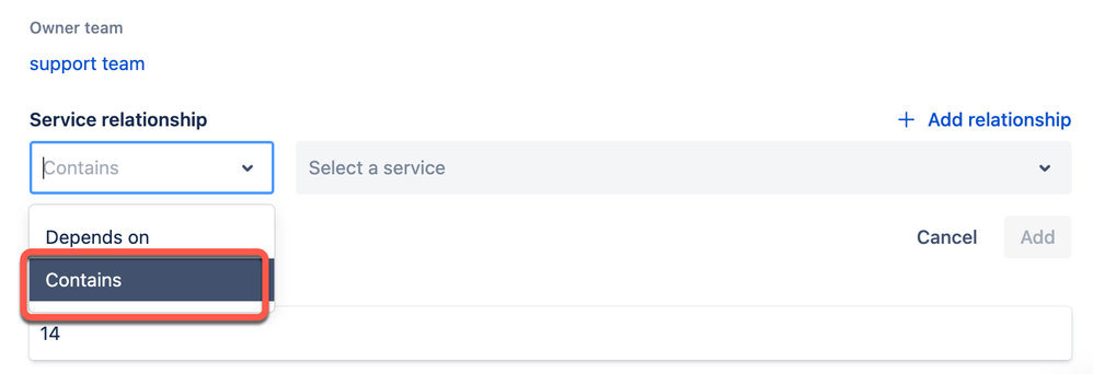

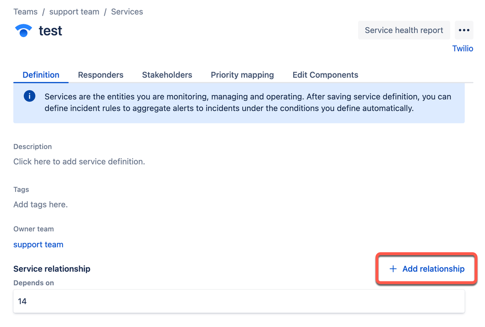

You should be able to add the 'contains' relationship here:

Hi @John M
sure, I could add the relationship manually. I just expected that when I link a relationship from one side (Service 2 depends on Service 1) that the link would automatically also appear on the other side (Service 1 contains Service 2). Comparable to issue-linking in Jira.
