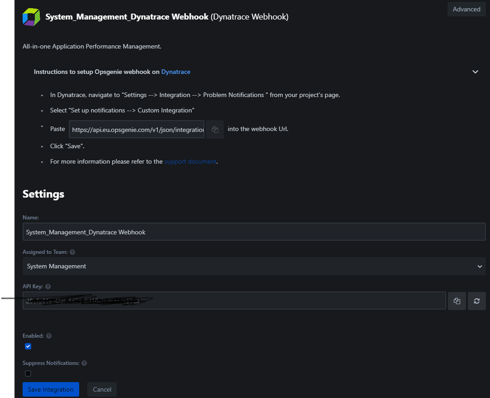

I have tested the Dynatrace Integration of OpsGenie. It works with the v1 integration. However, when using the v2 integration via webhook (Custom webhook in dynatrace) the alerts are not generated in OpsGenie. I followed the instructions on Integrate Opsgenie with Dynatrace Webhook (v2) | Opsgenie | Atlassian Support
Any sugestion how I can find out what's wrong?

Hi Nick,
Thanks for your input. We can see the alerts in the log of OpsGenie. However, they are for some reason not assigned to the team where the integration has been configured.
The alerts should be assigned to the team System Management but they don't. This does not happen with the "old" Dynatrace integration.

Hi Nick
Yes, I can confirm that the alerts are sent through the Default API.
We have now sent "real" alerts and they came through.
It is a bit confusing that the test-alerts are not mapped to the Team in OpsGenie but real alerts are.
