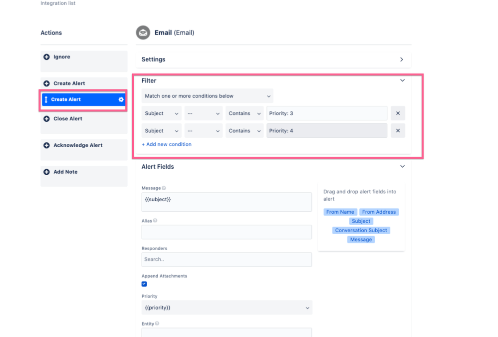

Hi @Scott Wright  - could you provide a screenshot of the email integration filter you have created? It sounds like you're trying to set a filter on an email integration to only create alerts if the subject contains "Priority: 3" or "Priority: 4", right?
If so, the following examples should work...
1. Just add a filter set to "match one or more conditions" that will create an alert if the subject contains either "Priority: 3" or "Priority: 4"

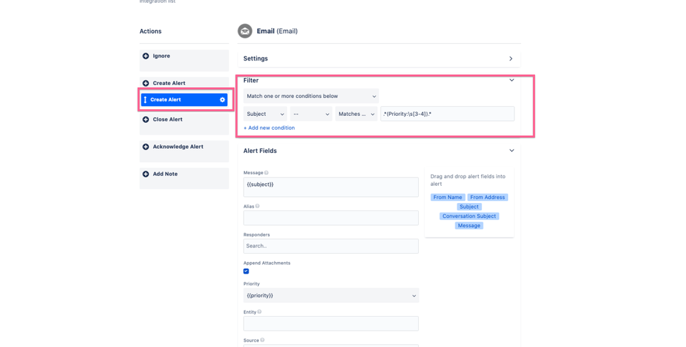

2. Setup the regex filter like this...
Either of those options should work if you're trying to have the integration create alerts only when it receives an email with "Priority: 3" or "Priority: 4" in the subject of the email.
Hope that helps!
