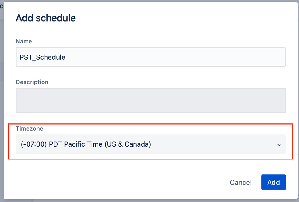

Please add two individual schedules with the timezone set up correctly and add the team members from these 2 different timezones into the right schedules.

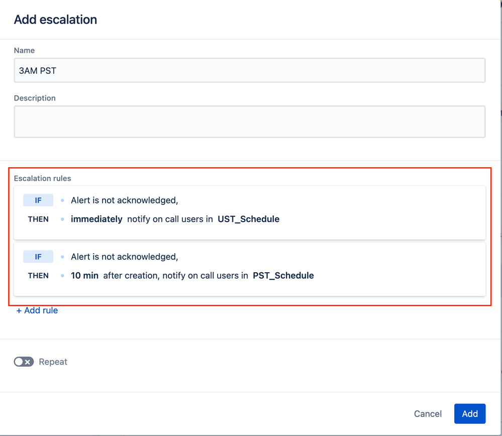

Please add 2 different Escalation policies for handling 2 different escalation paths for your descripitons:
An alert went off at 3 AM PST, but it went to all members simultaneously. We want it to go to people in UST first at that time, and then escalate to the PST team if it's not acknowledged after x minutes.
Conversely, if an alarm goes of at 4 PM PST, it should go to the PST team first, and not the UST team until x mins.

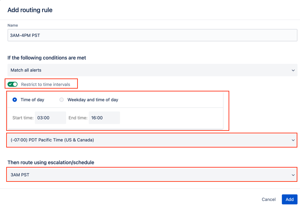

Please add at least 1 Routing Rule to set up the time constraint for 3AM to 4PM PST and route the alerts to the Escalation policy you set up for handling the alerts created at 3AM PST.

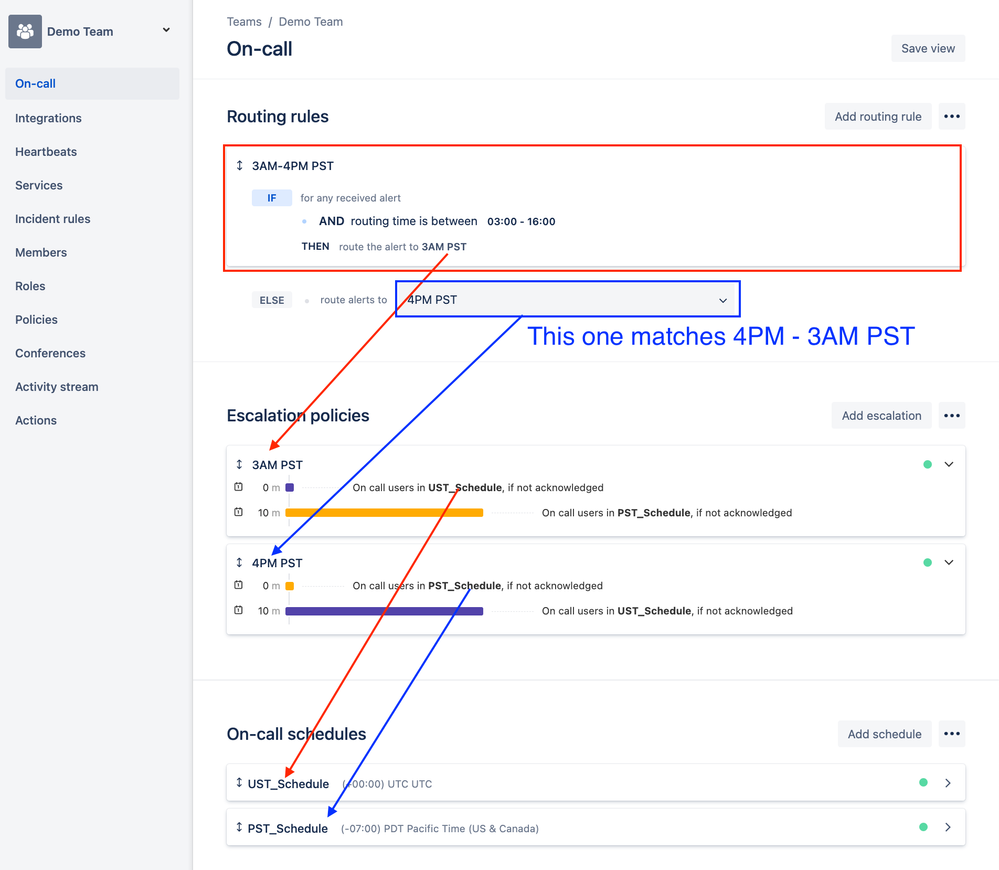

At the end of the setup, the screen should be looking like this:
Whenever an alert is created between 3AM-4PM PST and assigned to this team
-> Opsgenie routes this alert to the 3AM PST escalation policy following the Routing Rule
-> and this 3AM PST escalation policy will firstly route the alert to the on-call user at 3AM PST Schedule
-> if not acknowledged within 10 mins, the alert will be escalated to the on-call user in 4PM PST Schedule.
The main concept here is to follow this sequence: Routing Rule with time constraints -> Escalation Policy -> On-call Schedule for triaging the alerts properly.

Hi, thanks for the walkthrough. I was able to get most of it done, but unfortunately hit a snag at the end.
For your last screenshot, I got the "If" part to work ok, but for the "Else" part, I'm unable to select the other escalation I created. It's not available in the drop-down list and there's no way to type it in.
What am I doing wrong?

For the ELSE part of the Routing Rules, as long as you've created the Escalation policy within the same Team, it should be listed in the dropdown list upon clicking the field.
It could be helpful for having your browser's cache/cookies cleared or try on another browser to see if it works.

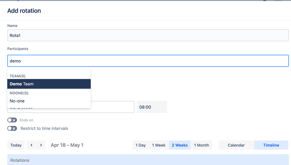

Sorry that I didn't make it clear. By mentioning the configuration related to Schedules, I mean adding the users into Rotation., and you may add the Team as Responders in each of the Rotation.

2. Create 2 On-call Schedules with the correct timezone setup to separate those users.
3. Add 1 Rotation to each of the On-call Schedules, and add the users into the corresponding On-call Schedule's Rotation by timezone.
i.e. Add 1 Rotation into PST_Schedule and 1 Rotation into UST_Schedule, and add those users in the PST timezone into the Rotation of the PST_Schedule, and vice versa.
