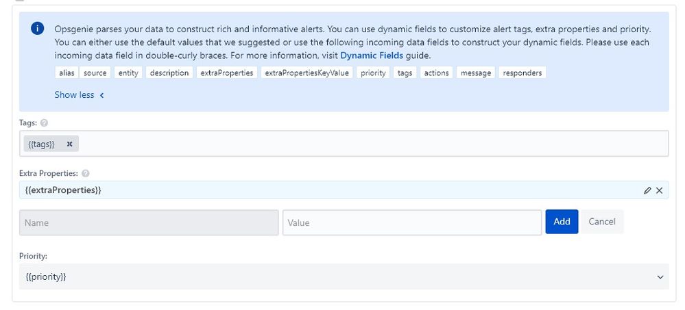

However the API integration page has space for adding Extra Properties key pairs
Is it:
Name Value
Node {{Node}}
Node {{details.Node}}
Node {{extraPropertiesKeyValue.Node}}
{{extraProperties}} {{extraPropertiesKeyValue}}
The documentation looks like the API Integrations page has changed and so not sure proper format.

The documentation looks a bit different because there are different plans and some plans have access to the "advanced settings" in the integrations.
You actually don't need to add anything to the ExtraProperties field; you can simply leave the default value of {{extraProperties}} there and then in the API payload you will need to add the extraProperties key (along with your values), which would look like this:

We're using the Alert API (https://docs.opsgenie.com/docs/alert-api), so we needed to put it in the key pair map as "details", and we also needed "isExtraPropertiesWithKey" (mentioned in https://docs.opsgenie.com/docs/integration-api#create-a-new-integration-action)
"details":{"key1":"value1","key2":"value2"},
"isExtraPropertiesWithKey": true,
In OpsGenie, would specifying {{details}} have worked instead of {{extraProperties}}?
@Mikel Stous You're right, it should be "details" as the key instead of "extraProperties" for creating the alert. I was using the integration API. But I was able to process it without the "isExtraPropertiesWithKey: true" flag, just using the default payload here: https://docs.opsgenie.com/docs/alert-api#create-alert
The "details" key in the payload will match up to "extraProperties" in the Opsgenie UI so you want to leave that as "extraProperties" on the integration.
