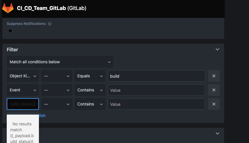

But in the Advanced setting in the integration I'm able to create alert policy when the Object Kind is equal to build, likely due to the fact both merge request and job events have the key object_kind in the payload
https://docs.gitlab.com/ee/user/project/integrations/webhooks.html#job-events
https://docs.gitlab.com/ee/user/project/integrations/webhooks.html#merge-request-events
 I do also  have the ability to get at items in the payload via the dynamic fields feature i.e. {{_payload.build_status }} https://docs.opsgenie.com/docs/draggable-fields#using-raw-parameters-from-webhook-url-payload-and-headers
While I can get access to the items in the payload in the Value field in an alert filter,
I can't set in the initial field we're looking at initially, see the screenshot on what I mean.

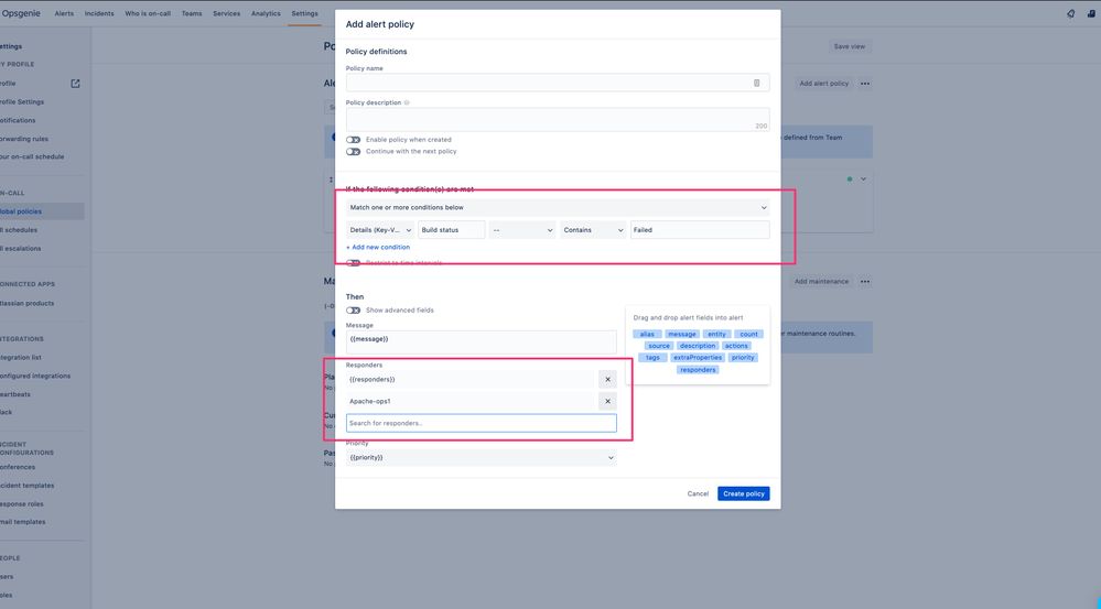

As a work-around though I could suggest that you utilize global policies/team routing rules depending upon how you have the integration current configured. For example, if this is a global integration you could set up that status to be pulled into the extra properties section of the alert and then you will be able to apply a filter condition based on that key-value pair via global policies, team policies, and team routing rules.

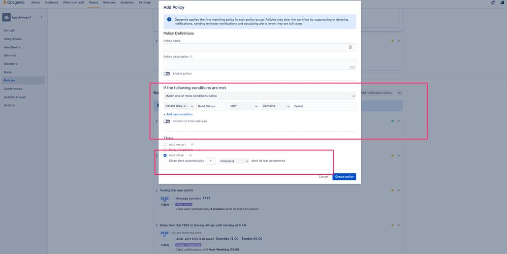

For example in this first screenshot I setup the global policy to match for the failed build and assign a team to that alert. This would be possible with the integration being global (not assigned to a specific team)

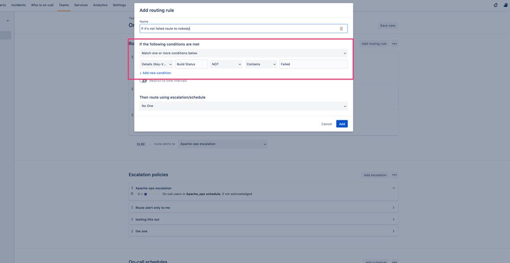

In the second screenshot, I am showing you how you could handle this on the alert routing rule portion if the integration is assigned to a team. Whenever the integration is assigned to a team and an alert is created via that integration the team's routing rules will be assessed. What this will do is essentially route the alert to nobody if the key value of build status failed is not in the alert. You could then set up a team notification policy to auto close those alerts that hit the team but are not routed anywhere. The final screenshot is what that would look like under the team that owns the integration.

This is a followup reply since it seems the screenshots I had created for you did not show. Opsgenie_-_Apache-ops1.jpgOpsgenie_-_Apache-ops12.jpgOpsgenie_-_Policies.jpg
